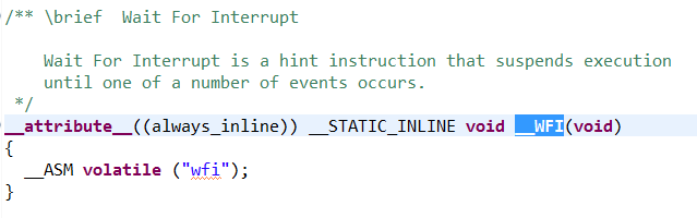

Hello Mark,
Thanks for the quick answer.
I actually didn't do that. Is that command correlated with the SLEEPDEEP set that is mentioned in the reference manual?
I just added this :
__WFI(); referencing this:
Does that seem correct?
I am still getting the same behavior. When I step over the __WFI(); line, the debug keeps going normally when I'm expecting it to stop.
Thanks!
EDIT: Just saw I need to do a read of last register before calling WFI, will try that and comment back.
EDIT 2: Still same behavior after a read of SMC_PMCTRL before __WFI();

mjbcswitzerland
Specialist V
Laurent
You may also be missing setting SLEEPDEEP in the Cortex system control register. Without this set the wfi() command sets the core to WAIT mode and not to a deep sleep mode and so the low leakage operation will not be achieved.
Mark
