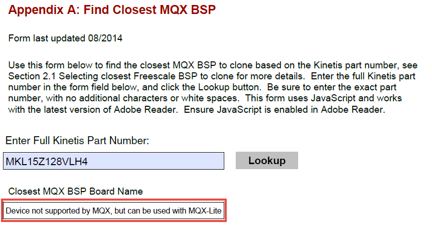

I'm not sure if this is right platform to ask but since there is no BSP support for MKL15Z128VLH4, we are looking for alternates for same part in MKL26 series...if anyone has any such info, psl share.

There is no support for MQX RTOS, you can only try it with MQX-Lite RTOS - with Processor Expert you add this component.
There will be support for MKL15Z4 in coming release for MQX RTOS for KSDK by the end of April.
But there is no relation with MKL26 series and MKL15Z128VLH4 for BSP.

ivadorazinova
You can use MKL16Z128VLH4 which definitely belongs to KL26Z series.
You can work with KSDK v.1.2.
