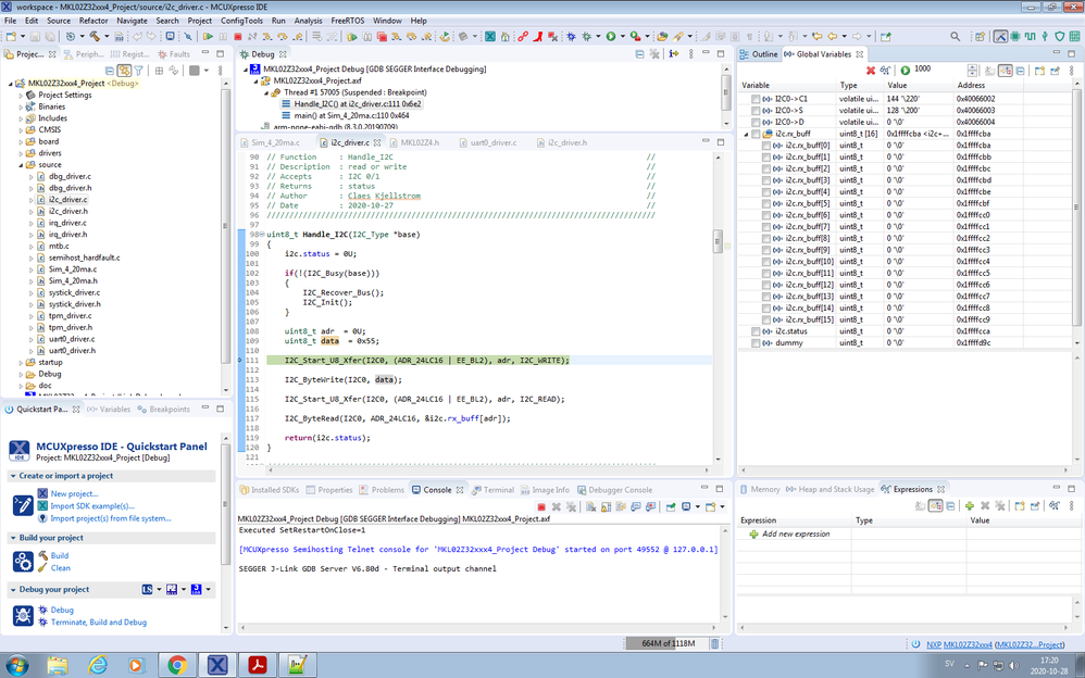

Hi, I've been reading this forum for any answers regarding the behaviour of I2C bus and find allways different answers depending on who's responding. I hade a project where it ended up in such long time before production so I hade to change the bus to SPI and it didin't took long before that was working .Unfortunatelly I needed som devices that required I2C(crap) bus in a new project. In this case I use I2C1 bus and have only one device(VL53L1X) and the other channel(I2C0) I have a 24LC16 eeprom. Now it seems that the writing to the EEprom is working, but the reading is a mess since I simply don't understand the datasheet from Freescale and never has at least regarding the I2C. Below are the functions and I do not use interrupt for I2C.

I have changed the read function a million times and the problem allways come with a dummy read becaus I don't have any control over the received byte.
The oscilloscope picture's which I haven't attached is correct for writing but when switching over rx mode and reading the dummy byte or even the last byte(NACK) I allways get 0xFF.
I have even tryed with some modification the KL05 I2C driver but that caused me to com up with a recovery solution whe I2C got stucked. I do have pullups(4K7) and I'm running at 100KHz.
Claes

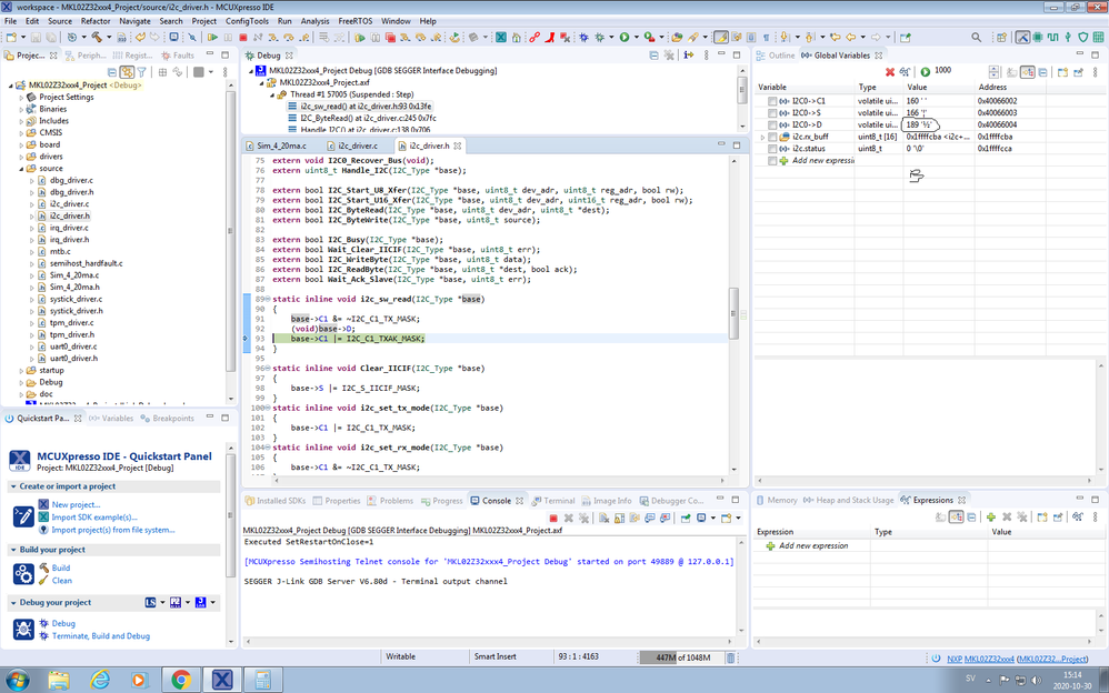

claeskjellstrom
Hi, I will continue this monolouge.
By reading Freescales flow diagram and comparing other solution for single read byte on I2C they seem to be roughly the same code with some minor changes. However it's difficult to understand that the real last byte to read is after a stop condition. As I see it when you make a stop then the result in the D-register is cleared so I will never catch that byte.
Any suggestions ?? I have copied some code from other examples below

My specific question after trying different solutions yesterday and reading datasheet word by word
is that following Freescales flowchart page 496 KL02 Reference Manual 3.1 July 2013, after switching over from transmitt to receive you should make a dummy read, giva a nack(only read 1 byte), then read the IICIF for received byte, make a stop, and read correct received byte, but when generating a stop the D register is cleared, why ?. I can go through your code but I would like to understand this behaviour.
Claes

See also Appendix A of https://www.utasker.com/docs/uTasker/uTasker_I2C.pdf which shows transaction flow based on practical tests. I never used the flow diagram in the user's guides since they are not always correct (the double-buffered version doesn't work at all if the flow chart is used as guide unless SW delays are added to work around issues with it). The uTasker I2C version has been used for >8 years in many industrial products without issues and so can be used as solid reference.
Specifically to your question:
The diagram shows the interrupt handler and not the actions required to get there.
Therefore in the decision marked as "End of address cycle (master Rx)" it means that the master has just successfully send the slave's read address and it is necessary to perform a dummy read to clear out the rx byte that was received during this transaction. This is the following in the non-interrupt code that I showed:
ptrI2C->I2C_C1 = (I2C_IEN | I2C_IIEN | I2C_MSTA | I2C_MTX | I2C_RSTA); // repeated start
ptrI2C->I2C_D = 0xa5; // EEPROM read address
_WAIT_REGISTER_FALSE(ptrI2C->I2C_S, I2C_IIF); // wait for the slave address to be sent
WRITE_ONE_TO_CLEAR_INTERRUPT(ptrI2C->I2C_S, I2C_IIF); // clear the interrupt flag (write '1' to clear)
ptrI2C->I2C_C1 = (I2C_IEN | I2C_IIEN | I2C_MSTA); // ensure we acknowledge multi-byte reads
(void)ptrI2C->I2C_D; // dummy read
The "Switch to Rx mode" just before it is presumably a firmware concept switch since there is no physical switch between modes in the I2C controller itself.
- Before the final byte is read one always switches the I2C controller to not send an ACK so that the slave recognises that the end of the transfer has been reached so "2nd to last byte to be read" not setting TXACK is correct.
In my reference it is done with
if (1 == iToRead) { // last byte to read
    ptrI2C->I2C_C1 = (I2C_IEN | I2C_IIEN | I2C_MSTA | I2C_TXAK); // we don't acknowledge last byte
- Generating a stop condition after receiving all data is correct and the uTasker driver reads the data after sending the stop bit so the flow diagram looks to match. Therefore this part of the diagram seems usable.
In case you are testing with a debugger attached and an I2C register view open you might have difficulties since it will be reading registers after each step and could be clearing out the Rx data before your code reads it. I don't think that the stop bit transmission itself will cause a problem with the Rx data register so it is likely that your observation technique is the cause of this issue.

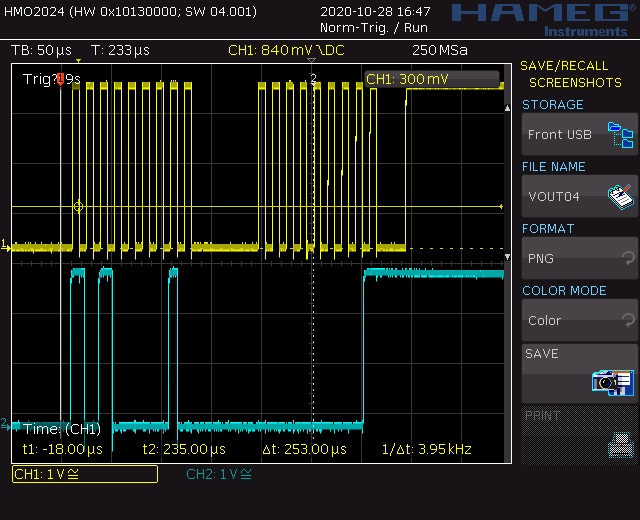

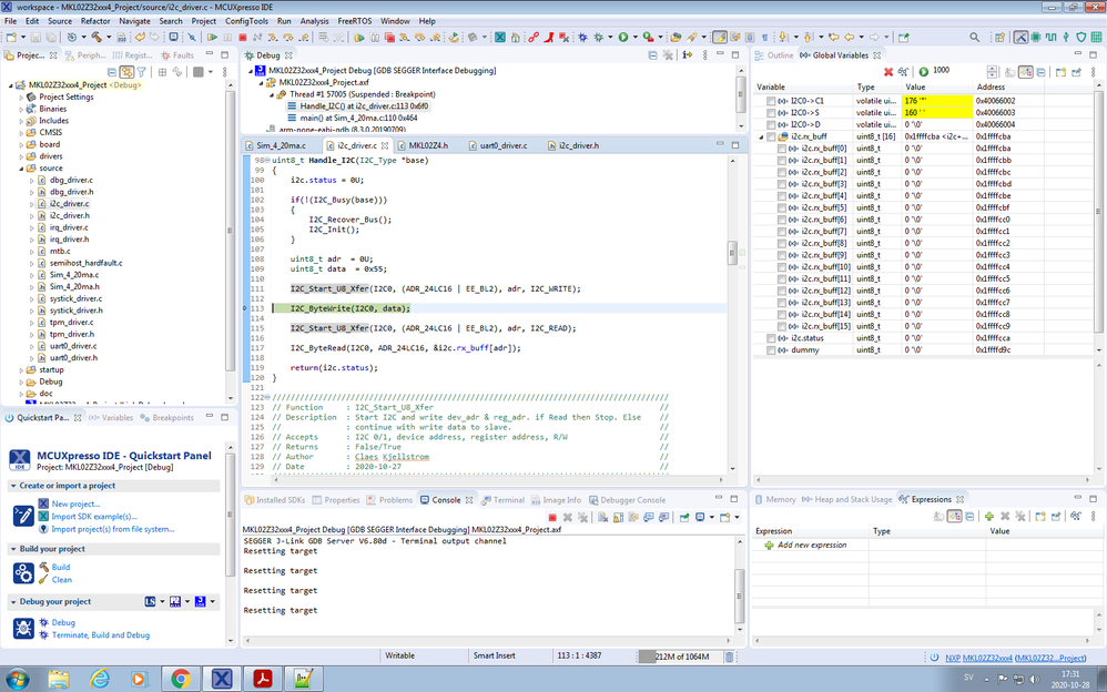

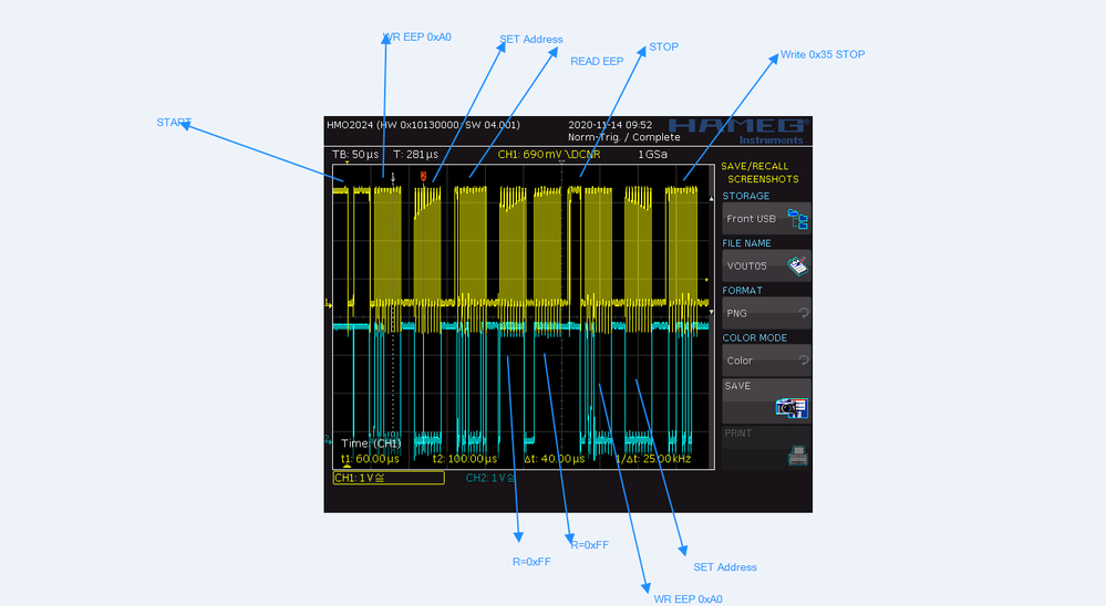

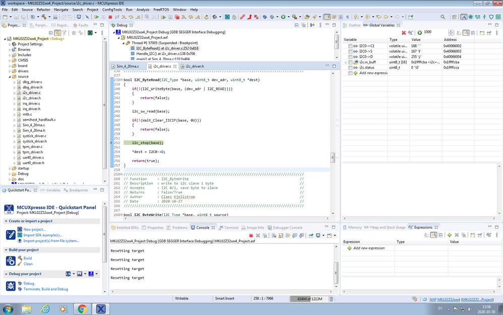

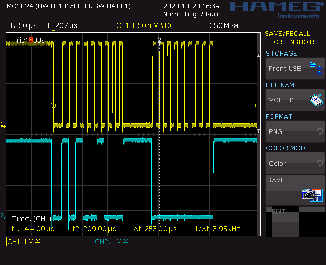

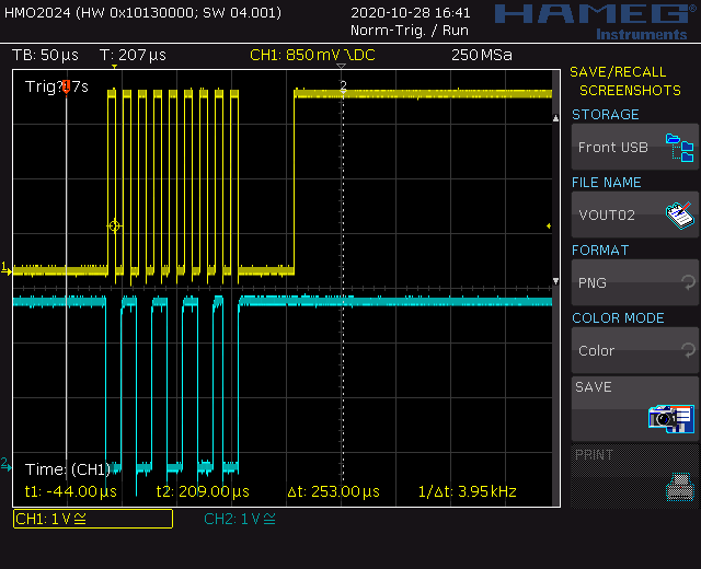

I've have decided that I should attache screenshots from my oscilloscope instead and screenshots when debugging, hopefully it's clear when looking at it. The order should be first i2c_write_1, VOUT1 etc.. please let me know if you see anything because I'm blind.
Claes
i2c_write_1.pngi2c_write_1.pngi2c_write_2.pngi2c_write_2.pngi2c_read_1.pngi2c_read_1.pngi2c_read_2.pngi2c_read_2.pngVOUT01.PNGVOUT01.PNGVOUT02.PNGVOUT02.PNGVOUT03.PNGVOUT03.PNGVOUT04.PNGVOUT04.PNG

Since I've got to upset about the eeprom I changed to reading LPS25H register 0x0F which is "WHO_AM_I" and it should reply 0xBD which it does on the scope but is either 0x00 or 0xFF when reading I2C0->D. When I stop the value is cleared, so dummy read gives 0xFF and stop 0x00.
Down below all inlines for switching(nothing has changed since last time.
static inline void i2c_sw_read(I2C_Type *base)
base->C1 &= ~I2C_C1_TX_MASK;
uint8_t test = base->D;                                             //Will change to void later
base->C1 |= I2C_C1_TXAK_MASK;
static inline void Clear_IICIF(I2C_Type *base)
base->S |= I2C_S_IICIF_MASK;
static inline void i2c_set_tx_mode(I2C_Type *base)
base->C1 |= I2C_C1_TX_MASK;
static inline void i2c_set_rx_mode(I2C_Type *base)
static inline void i2c_give_nack(I2C_Type *base)
static inline void i2c_give_ack(I2C_Type *base)
base->C1 &= ~I2C_C1_TXAK_MASK;
static inline void i2c_repeated_start(I2C_Type *base)
base->C1 |= (I2C_C1_RSTA_MASK | I2C_C1_TX_MASK);
static inline void i2c_start(I2C_Type *base)
base->C1 = (I2C_C1_IICEN_MASK | I2C_C1_MST_MASK | I2C_C1_TX_MASK);
static inline void i2c_stop(I2C_Type *base)
base->C1 &=~(I2C_C1_IICEN_MASK | I2C_C1_MST_MASK | I2C_C1_TX_MASK);
Any clues ??
Claes
13,572 Views
claeskjellstrom

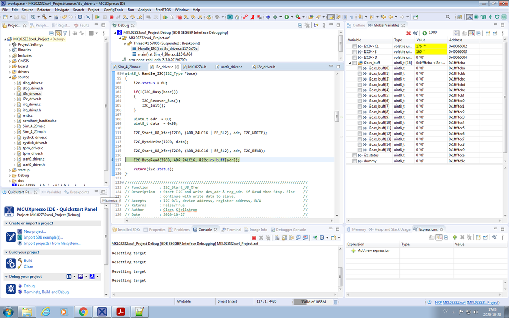

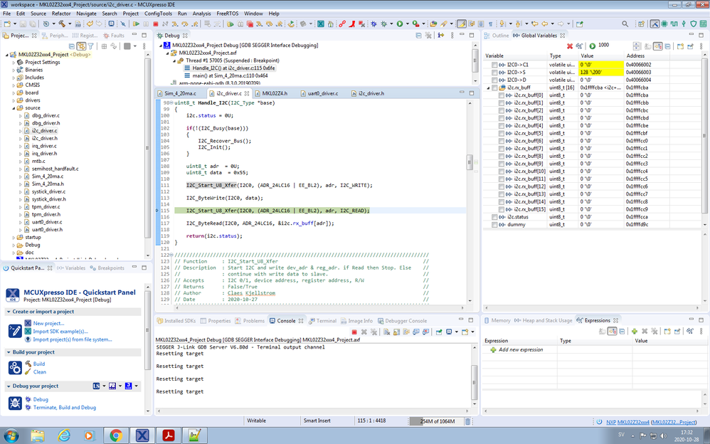

I have invoked a screendump when I set a breaking point/running to line just after dummy read and now for some strange reason the "WHO_AM_I" value seems to be correct(0xBD/189 dec), even though I have not yet NACK the byte nor have I done a stop or even read the IICIF and clear it. The code after this is.
if(!(Wait_Clear_IICIF(base, 0U)))
return(false);
i2c_stop(base);
*dest = I2C0->D;
return(true);
Hope this help
Claes

Hi, so here we go with another board, and I'm out of any ideas whatsoever. I'm running at ~300KHz and ~100KHz. What I can see or suspect is that somewhere down the line I miss something. If I run the code all the way from setting the address I want to read from and stop emulation after the bus has switch to "READ"
Then running READ 16 bytes with a new eeprom the contents are all 0xFF which is correct. If I don't stop the emulation and let it run from start to stop the contents are all 0x00.
Start init
uint8_t eep_handle(I2C_Type *base)
if(!(I2C_Busy(base)))
return(i2c.status);
else
/* reading 16 bytes from block 0 starting at 0 */
eep.adr = 0U;
/* setup for reading block-0 16 bytes and check if unprog. */
i2c.i2cp = &eep.buff[0U];
/* read 16 bytes of eeprom block 0 and verify if un-programmed */
I2C_Start_U8_Xfer(base, (ADR_24LC16 | EE_BL0), eep.adr, I2C_READ);
I2C_MultiRead(base, (ADR_24LC16 | EE_BL0), EE_BLK_SIZE);
/* verify if blank/prog. a prog sets eep.blk */
if(!(verify_eep_block(&eep.buff[0U])))
eep.blk = 1U;
return(true);
Here is the setting of Write address
bool I2C_Start_U8_Xfer(I2C_Type *base, uint8_t dev_adr, uint8_t reg_adr, bool rw)
if(I2C_Busy(base))
i2c_start(base);
Clear_IICIF(base);
else
return(false);
if(!(I2C_WriteByte(base, (dev_adr | I2C_WRITE))))
return(false);
if(!(I2C_WriteByte(base, reg_adr)))
return(false);
if(rw)
i2c_repeated_start(base);
return(true);
And here is the last setting of READ and then 16 bytes
bool I2C_MultiRead(I2C_Type *base, uint8_t dev_adr, uint8_t nr)
if(!(I2C_WriteByte(base, (dev_adr | I2C_READ))))
return(false);
i2c_sw_read(base);
while(nr-- > 1U)                                               // Here I stop the emulation from start, then I start to
if(!(I2C_ReadByte(base, _ACK)))
return(false);
if(!(I2C_ReadByte(base, _NACK)))
return(false);
i2c_stop(base);
return(true);                                              //Here....But if I run all the way to here from start the contents                                                                     // will be 0x00
WHy ???????????????????????????????????
13,463 Views
claeskjellstrom
Another observation, I start to read only 2 bytes from eeprom at address 0x00 and both bytes are 0xFF, then STOP.
Then I write 1 byte data to address 0, the data is 0x35, and STOP. I'm not using the debugger and the code is compiled in release mode without any optimisation. So I simply turn the power ON/OFF to see the whole i2c stream on the scope. But.... after writing 0x35 and generate a STOP the SCL is still low.
Claes
