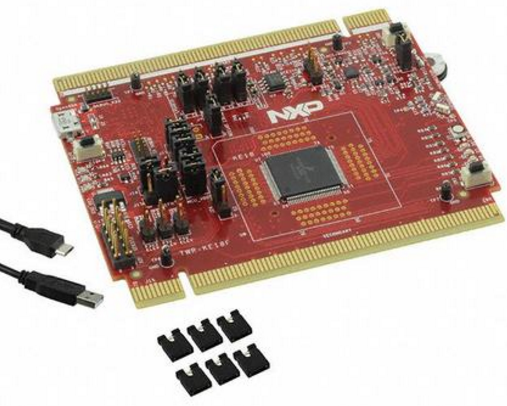

Hi:

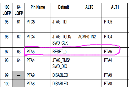

         My MKE18F512VLL16 cannot download program anymore!The reason is that the JTAG/SWD pin is used as a GPIO,and then the board cannot download program anymore!

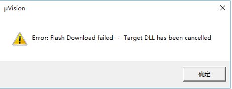

We have the following error message after click "Load" icon in spite of complete build without error.
    Program Size: Code=980 RO-data=1076 RW-data=12 ZI-data=2060
   "release\led_blinky.out" - 0 Error(s), 0 Warning(s).
   Build Time Elapsed: 00:00:04
   Load "release\\led_blinky.out"
   Error: Flash Download failed - Target DLL has been cancelled
   Flash Load finished at 10:49:46
Here is screen shot.

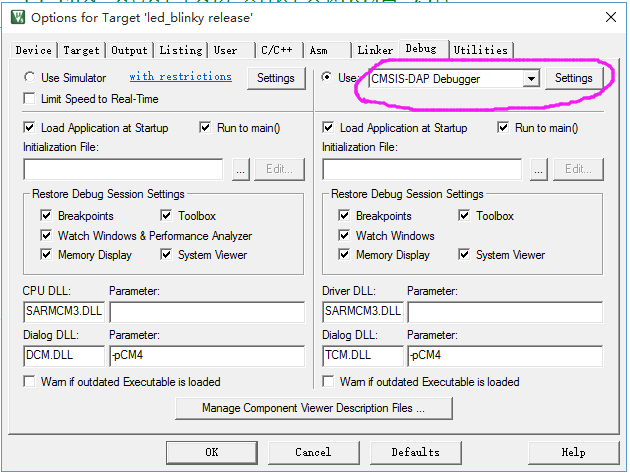

And the screen shot of "Options for Target" as following:
Now I want to know how to download program to cover the previous code.

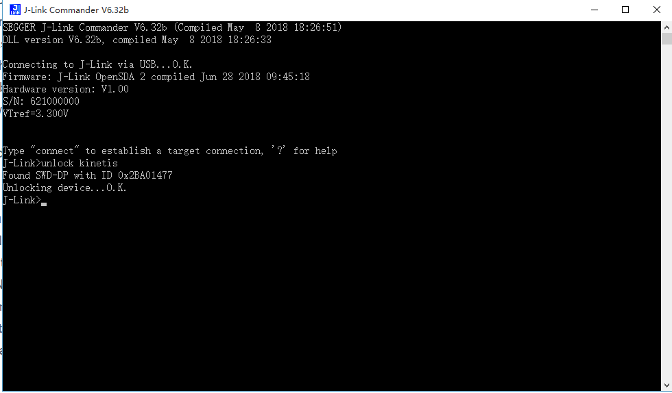

Hi zy,
   Please don't worry.
   If you didn't also modify the reset pin to gpio, it's ok to recovery it.
   Now, please change the on board debugger to JLINK at first. Then use the JLINK commander to do the mass erase at first.
1. change the on board debugger to JLINK
   enter the bootloader mode, copy the JLINK firmware to the bootloader.
   The firmware can be downloaded from this link:
SEGGER - The Embedded Experts - Downloads
  The Jlink driver you also need to installed:
2. After you change your on board debugger to JLINK
  open JLINK commander under the JLINK driver, press the reset button, then try to connect it.
  If you can't connect it, press the reset button, and hold on it.
  in the JLINK commander, input: unlock kinetis
  This command will do the mass erase, then your SWD will be saved.
Please try it on your side.

Hi Kerry,
     Today, I retry to input the "unlock kinetis" command with the J-LINK commander tool. And it writes that "Found SWD-DP with ID 0x2BA01477        Unlocking device...O.K."
    But when I turn buck to  bootloader mode, it is also cannot dowload program.
   After the command--"unlock kinetis"  works out ,  what should I do.
  Looking for your help.Have a good day.
  qzy

   I suddenly find that I did also modify the reset pin to gpio. I am very worry that If  it cannot to be recovered.
   I am so sorry to my board, making it being a unuseful brick.

Hi Kerry,
   As you can see in the following figure, the J-link isn't connect successfully. And when I write "unlock kinetis", it warning that “Read from DP/AP register failed!”

Firstly, thank you for your quick reply. I think your idea is great, but I find it that my board hasn't a Interface of JLINK.
So, if there is another methods to solve this tricky problem?
