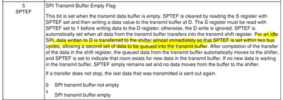

The problem I had with this was when you run the SPI_SlaveTransferNonBlocking function it will automatically load 2 Bytes into the Spi TX buffer because the interrupt for an empty TX buffer (SPTEF) will trigger when the function enables spi interrupts. So even if I run the abort function its going to send those 2 preloaded bytes out of the Spi TX Buffer first which offsets any replacement messages data. The abort doesn't do anything to clear the clear the Buffer as shown, it just clears the SPI Handlers count of remaining bytes and disables the interrupt. Thats it. FSL_FEATURE_SPI_HAS_FIFO is set to 0 FYI for this chip.

My solution to this was to have the MKE04Z keep track of when it had loaded dummy data in waiting for any random message to arrive, so that way it could have the master read that dummy message out first then read again for the real message. This sort of worked but after 2 transfers the first byte in the RX buffer on the master side would be wrong. This was really confusing to me, so I set a breakpoint in the interrupt code in the slave MKE04Z side spi driver that continuously loads data into the data register when the TX Empty interrupt triggers, to see if it loaded in the 1st byte correctly.

The break point triggered 2 times and loaded the 2 bytes correctly. So I am not sure what is going on. I am not sure how only the first byte could be wrong and not 2 bytes because the TX Buffer seems to load in 2 bytes to fill the buffer which it says it is supposed to in the reference manual.
