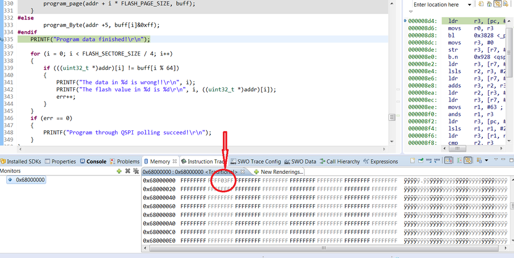

Then when we write the data to TxBuffer, we must write the byte 4 times. This is because a write transaction on the flash with data size of less than 32 bits will lead to the removal of four data entry from Txbuffer. The valid bit will be used and the rest of the bits will be discard.
Then before we start programming, we must set the data size.
     QSPI_SetIPCommandSize(EXAMPLE_QSPI,1);
After byte program, we can see the result from 0x68000000.
Attachment is the demo project. You can find that 0x03 was written to 0x68000005 after running.
