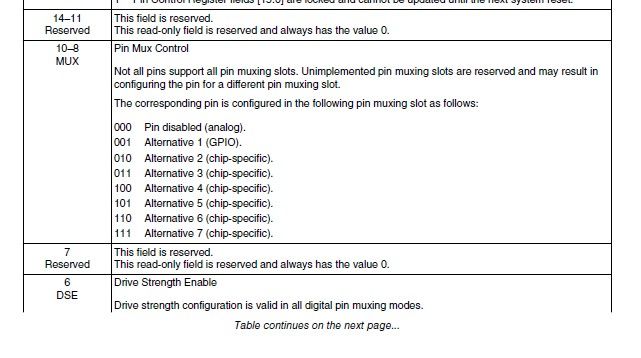

FRDM-K64F uses MK64FN1M0VLL12 processor.
In reference manual different register configurations referee to chip-specific configuration.
For example PORTx PCRn (page 283)  in K64 Sub-Family Reference Manual
Document Number: K64P144M120SF5RM Rev. 2,
January 2014
Where this chip-specific can be found and downloaded ?

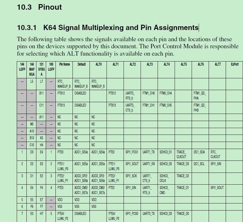

Hi shaul dorf,
    Actually, if the chip using the same reference manual ,then the register configuration is the same.
     From the above picture, you will get that MK64FN1M0VLL12 should refer to this document, the reference manual which you are referring is correct.
    If you want to choose the MUX, and don't know which alternative chip-specific mean, please refer to page 246, 10.3.1 K64 Signal Multiplexing and Pin Assignments, here you will get the detail ALTn function.
Wish it helps you!
Jingjing
