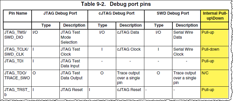

8.Check the circuit of debug interface:

nbjasani
3. I checked in oscilloscope at pin NMI_b/EZP_CS_b: It shows 3.3V Constant due to internal pull up.
6. I did multiple power cycles with debugger connected, but still problem persist.
8. JTAG_TMS = Pullup = 3.28V (Measured Value)
    JTAG_TCLK = Pulldown = 62mV i.e. 0V.(Measured Value)
    JTAG_TDI = Pullup = 3.27V.(Measured Value)
    JTAG_TRST = Pullup = 62mV i.e. 0V.(Measured Value)
Note: After assembling PCB with components, first we only give VDD and VSS, VDDA and VSSA is not supplied at that time. This can create problem? Is there any power sequence require between VDD and VDDA?
Nandish Jasani.

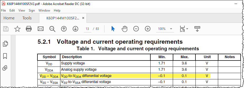

6,129 次查看
Robin_Shen
VDD and VDDA should be power at the same time:
5.2.1 Voltage and current operating requirements.png5.2.1 Voltage and current operating requirements.png
6,109 次查看
nbjasani

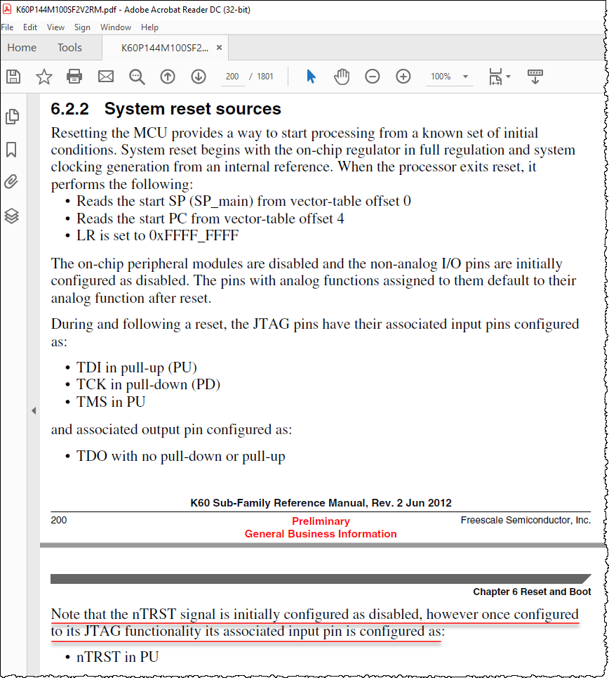

   We are ensured that VCC an VCCA are powered on same time. In my schematic JTAG Reset pin is kept open and according to datasheet it should be pull up, But after power up JTAG Reset pin is low all the time. Pin no. 55 in MK60DN512VLQ10. Is this will effect MCU Reset pin?
Nandish Jasani.
6,082 次查看
Robin_Shen
Note that the nTRST signal is initially configured as disabled. So it's not the issue. And you should be able to connect MCU by SWD interface too.
Since your initial power supply doesn't meet the datasheet requirements, I'm not sure if that's the problem. I wonder if you have other circuit boards that have not been soldered, try to supply power at the same time to check if the problem still exists.
Hold the RESET_b(pin 74) low, are you able to connect the MCU by Multilink Universal?(Please update the driver https://www.pemicro.com/products/product_viewDetails.cfm?product_id=15320180&productTab=4) It is recommended to submit technical support to PEMicro to ask if there is a method similar to JLink to access the MDM-AP status and control registers.
