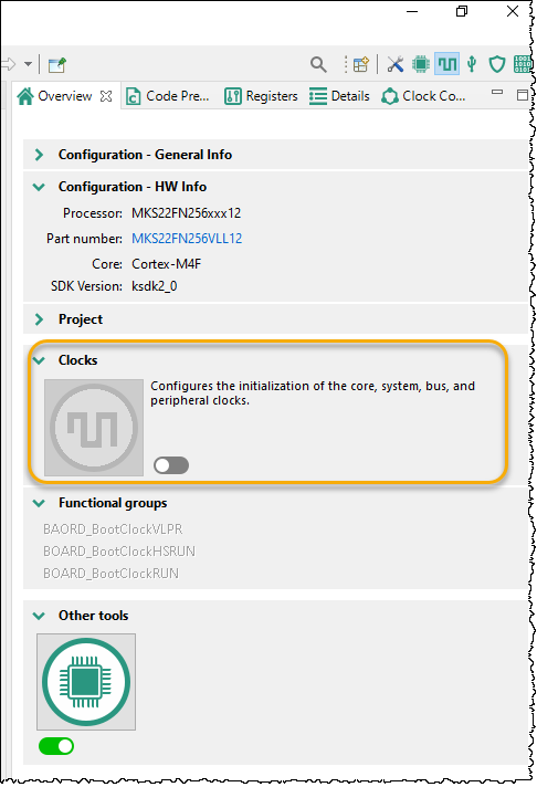

i have a Problem with the Clock generation of the Config Tool.
The Init routine which is generated uses a different type "sim_clock_config_t".
The generated code tries to initialise the following:
const sim_clock_config_t simConfig_BOARD_BootClockRUN =
.pllFllSel = SIM_PLLFLLSEL_MCGPLLCLK_CLK, /* PLLFLL select: MCGPLLCLK clock */
.pllFllDiv = 0, /* PLLFLLSEL clock divider divisor: divided by 1 */
.pllFllFrac = 0, /* PLLFLLSEL clock divider fraction: multiplied by 1 */
.er32ksrc=SIM_OSC32KSEL_RTC32KCLK_CLK, /* OSC32KSEL select: RTC32KCLK clock (32.768kHz) */
.clkdiv1 = 0x1020000U, /* SIM_CLKDIV1 - OUTDIV1: /1, OUTDIV2: /2, OUTDIV4: /3 */
in fsl_clock.h the type is defined like this:
typedef struct _sim_clock_config
uint8_t pllFllSel; /*!< PLL/FLL/IRC48M selection. */
uint8_t er32kSrc; /*!< ERCLK32K source selection. */
uint32_t clkdiv1; /*!< SIM_CLKDIV1. */
} sim_clock_config_t
Of course this fails to compile then.
I use SDK  Version 2.4.1 (which is the newest one, though its quite old)
What can I do except commenting this out (because this is reverted every time i use the Config Tools)?
greetings
Roland

Hi Roland,
You can refer the answer in: SIM Clock Config Error
If you do not use the Clocks tool (only the Pins tool), then you can try to disable the Clocks tool.
Sorry for the inconvenience we bring you!
Robin
