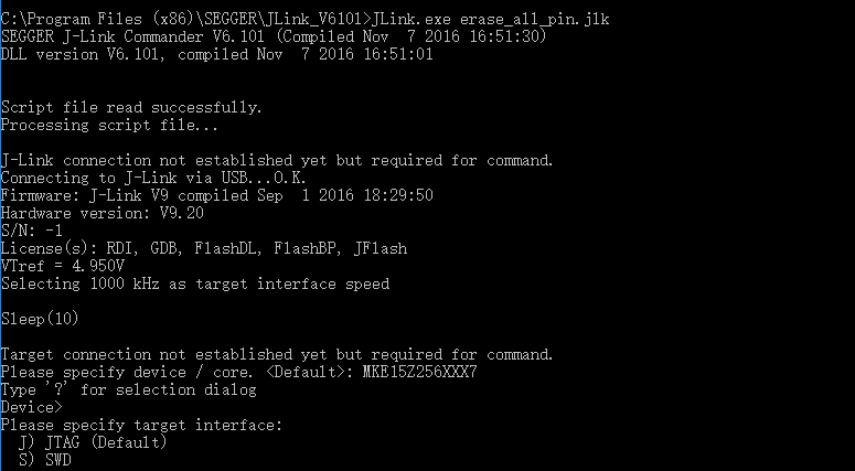

    We are using MKE15Z256VLL7 microcontroller,But encounter problems.
MCU suddenly can not download the program.list is the JLink.exe`s log:
Connecting ...
 - Connecting via USB to J-Link device 0  - Target interface speed: 4000 kHz (Fixed)  - VTarget = 4.962V  - ERROR: Kinetis (connect): Communication error while accessing MDM-AP.  - ERROR: Failed to connect. Could not establish a connection to target.
We suspect that MCU is locked up,So we're trying to unlock it,Here is our way to unlock and screenshots.
Eager for your help, thank you!

My version of the jlink directory is different and does not have an erase_all_pin.jlk . I have versions:
C:\Program Files (x86)\SEGGER\JLink_V642b
and
C:\Program Files (x86)\SEGGER\JLink_V644f
Is there some other option to accomplish this task ??

C:\Program Files (x86)\SEGGER\JLink_V644f>jlink.exe erase_all_pin.jlk
SEGGER J-Link Commander V6.44f (Compiled Apr 12 2019 17:17:37)
DLL version V6.44f, compiled Apr 12 2019 17:17:02
Unknown command line option erase_all_pin.jlk.

Please refer attached document about how to unlock the Kinetis chip.
Customer could follow the step 6: Using Erase_all_pin.jlk script with J-Link tool.
Wish it helps.
