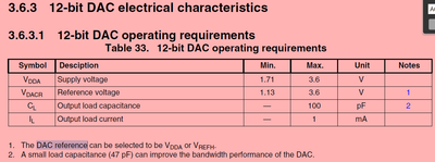

BUG 2: DAC section (page 38 of datasheet), it said DAC reference can be selected to be VDDA or VREFH. but in reference manual, DAC reference only be selected to be VREFH or internal 1.2V.

BUG 2: page 38 of datasheet, see below screenshot, I don't know why i have no permission to upload images.  "The DAC reference can be selected to be VDDA or VREFH" in page 38 of datasheet. you can search the previous words in datasheet and found it. as you can see your shared RM pitcture, DAC reference can be selected from VREF_OUT and VDDA.   RM doesn't match with datasheet. it's a error in datasheet or RM.

Yes. difference on DAC reference voltage between datasheet and RM documents, i'm not sure is a descreption error or bug. from my  point, i think DAC ref voltage should has 3 options: VDDA/VREFH/internal 1.2V. but i don't know why has this error. if it's actual, which one is right? shall we following RM's descreption?

For the DAC reference source, it should be VDDA and VREF_OUT, not VREFH.
