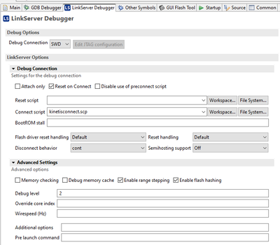

6. linkserver configuration is the following in the IDE (using mass erase under GUI Flash tool tab and I also tried to use various reset scripts provided in the linkserver by default):

I already read through  this forum https://community.nxp.com/t5/MCUXpresso-General/LPC1758-Cannot-halt-processor/m-p/1368631 and this https://community.nxp.com/t5/LPCXpresso-IDE-FAQs/Regaining-debug-access-to-target-MCU/m-p/473923 but I don't think I can use ISP with this MCU (let me know if i'm wrong).
The result is that it is not possible to halt core. I don't understand what it means since I'm new to  programming at this level:

Hello, my name is Pavel, and I will be supporting your case, this issue is the common "Cannot halt processor" Maybe you could recover the control with a mass erase on the target MCU.
Pavel
