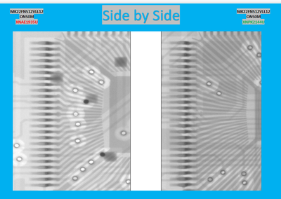

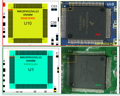

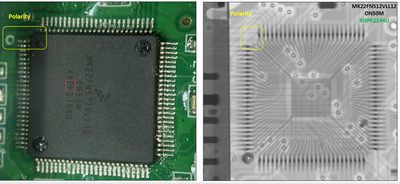

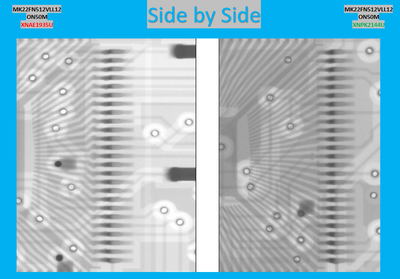

The new batch of materials cannot accept the boot loader. Their silk screen marking is XE (batch 2019). I took the parts we could accept the boot loader normally (silk screen marking is PK, batch 2021) to compare. X-ray is as the attachment.
Please help me confirm whether they have changed the wafer. If so, what has changed between them? Is the ID the same?

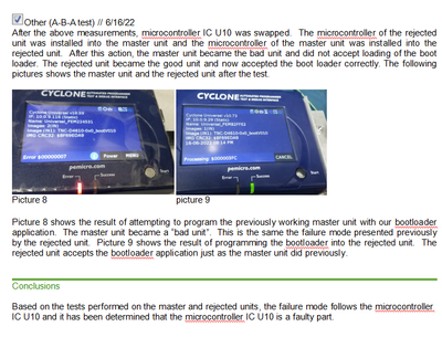

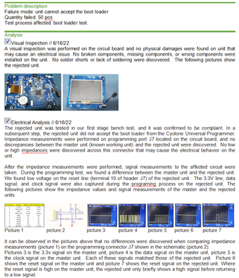

The last picture in the second picture is as follows:
 As you can see, when accept the boot loader for the faulty chip (the silk screen is AE), his RST is faulty.
  The one in the upper left corner of the figure below.
[KK]E{X)K7T@OVNV6MAYN9U.png[KK]E{X)[email protected]
We mainly want to know whether the firmware burned by these two different silk screen printed chips is consistent when they leave the factory, and whether the hardware design around them is consistent. Otherwise, according to our understanding, they will not be unable accept the boot loader.

As for your pictures: they are interesting, mostly they show a different PCB underneath with different traces/vias. And you see the packaging pins/leads/traces, but not the silicon itself with details.
