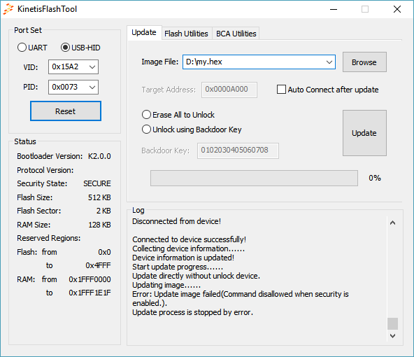

I tried to set it to:
.section .FlashConfig, "a"
.long 0xFFFFFFFF
.long 0xFFFFFFFF
.long 0xFFFFFFFF
.long 0xFFFFF908
This way KinetisFlashTool shows that the security state is "SECURED" and the update of my app is not possible:
Updating image......
Error: Update image failed(Command disallowed when security is enabled.).

is that I can't update my app using flash resident bootloader (KinetisFlashTool.exe), because KinetisFlashTool.exe outputs:
(if I don't secure my chip then the update works)

This is printscreen of KinetisFlashTool:
I also tried to set "Erase All to Unlock" without success - obviously, as this is probably trying to mass erase the device and it would mass erase also the bootloader which is at the beginning of the flash memory. I don't want to use backdoor key.

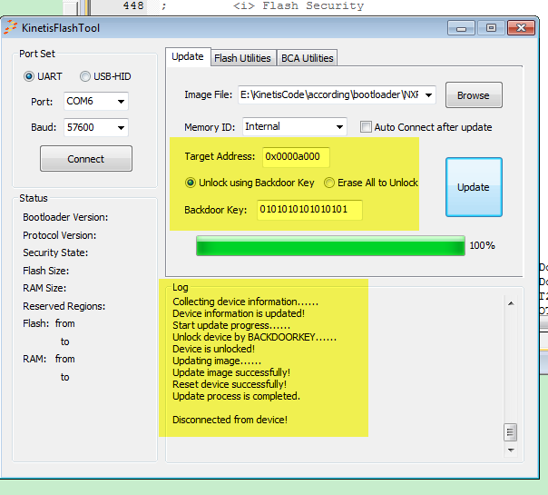

 Now, follow me to use the backdoor key, and secure the flash bootloader.
1. In the flash bootloader
  1)Set the backdoor key, take an example:
BackDoorK0      EQU     0x1
BackDoorK1      EQU     0x1
BackDoorK2      EQU     0x1
BackDoorK3      EQU     0x1
BackDoorK4      EQU     0x1
BackDoorK5      EQU     0x1
BackDoorK6      EQU     0x1
BackDoorK7      EQU     0x1
2) FSEC enable the backdoor key and secure the chip
FSEC          EQU     0xbf
2. In the KinetisFlashTool, please do it like this:
Now, it works perfectly.
Please try it on your side.
Any updated information from your side, please kindly let me know.
Kerry

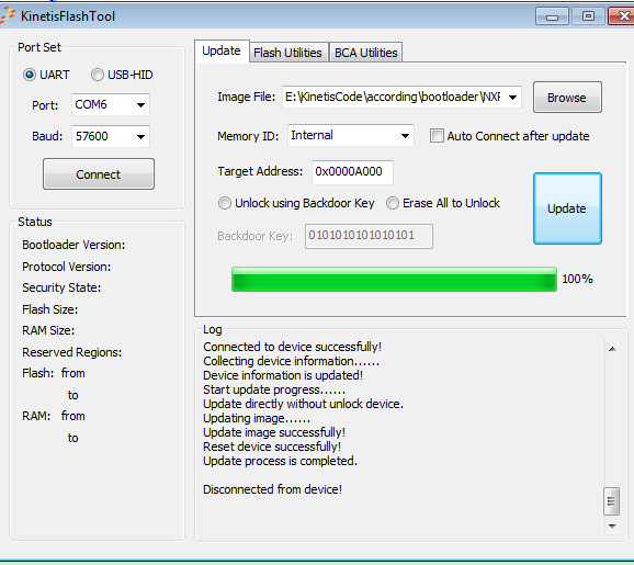

Yes, I modified that (for me it is on line 117, I use NXP_Kinetis_Bootloader_2_0_0).
No, you can't do erase all to unlock, this operation is not allowed.
I just select update file and perform update. Sector erase operation and flash write is allowed.
5,844件の閲覧回数
kerryzhou
Hi Martin,
   You are right, if not select the erase all to unlock, it works ok, this is my test result:
You can use it now.
Thanks a lot for your effort.
