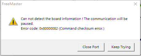

can't get my KE02board connected to FreeMaster
804件の閲覧回数
cairui970204
This problem occurs when I click “Start/Stop communication” button in FreeMaster,after I’ve debugged&downloaded the programs to KE02.
Wondering how to sovle this,thx!
1 返信
734件の閲覧回数
jingpan
This means a communication error has occurred, the command's checksum value was invalid. When KE02 freemaster code receive an error command,  it will notify host computer. There is a error code FMSTR_STC_CMDCSERR in freemaster_protocol.h. You can monitor it in debug.
