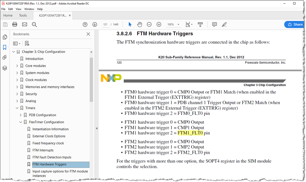

The FTM Hardware Triggers can be found in Reference Manual.(The FTM1_CH1 can not act as trigger input pin.)

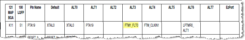

Not sure if you must use FTM1, due to FTM1_FLT0 share the same pin of XTAL0.(Maybe you can use other FTM module.)

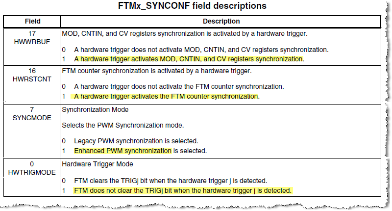

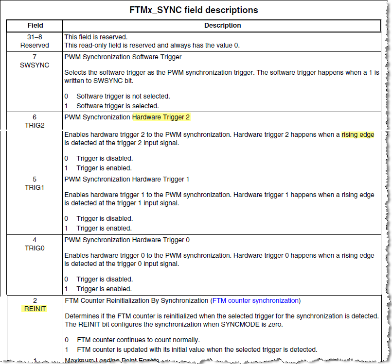

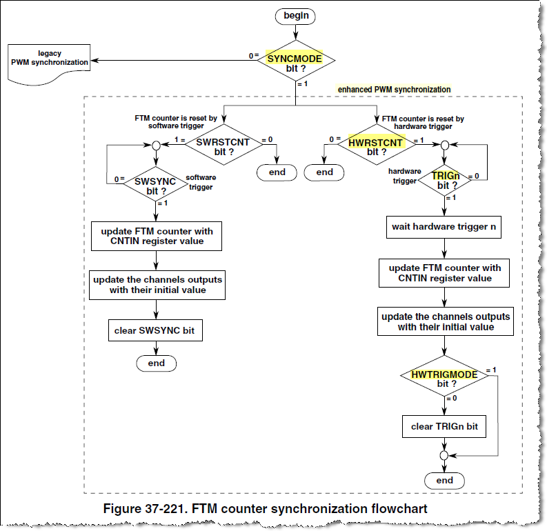

Please check if you want to achieve the FTM counter synchronization shown below:
Then you may follow the FTM counter synchronization flowchart, and configure the corresponding register.
