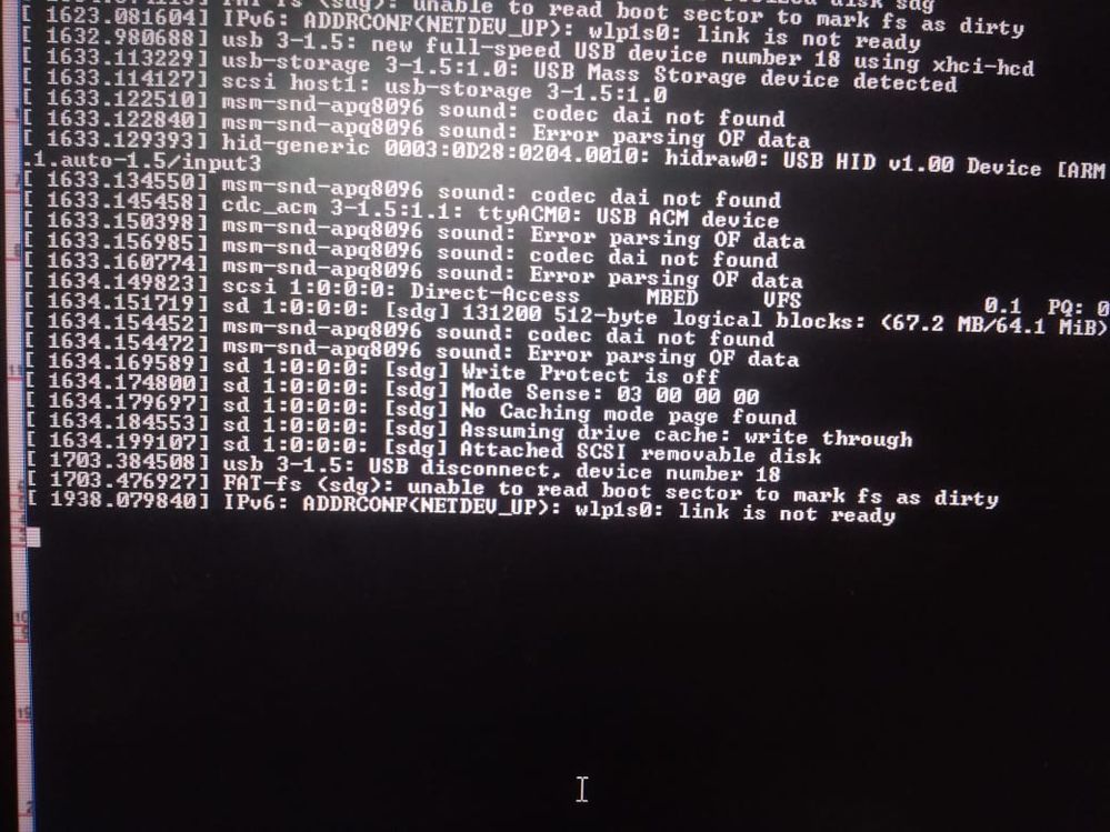

kumarnarendrasi
Hello Kerry,
We had it programmed the Boot loader again. This time when I probe the RESET, the pin 29 goes low continuously(Pulsed waveform). Also the FRDM_K66 storage in Linux shows only when I touch the RESET pin with either the DSO probe or a multimeter. When I remove the probe the storage gets disappeared
Below is the log We had when I did the above mentioned experiment. It starts from around 10 lines from the bottomK20_Usb_Log.jpeg
Please help me out.
Raj

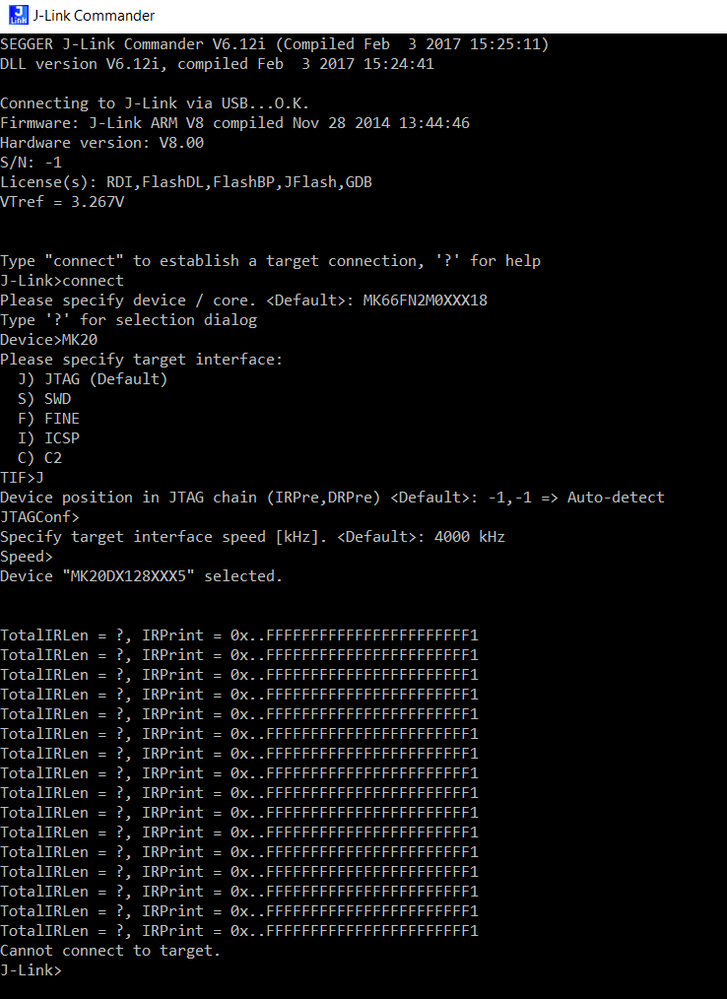

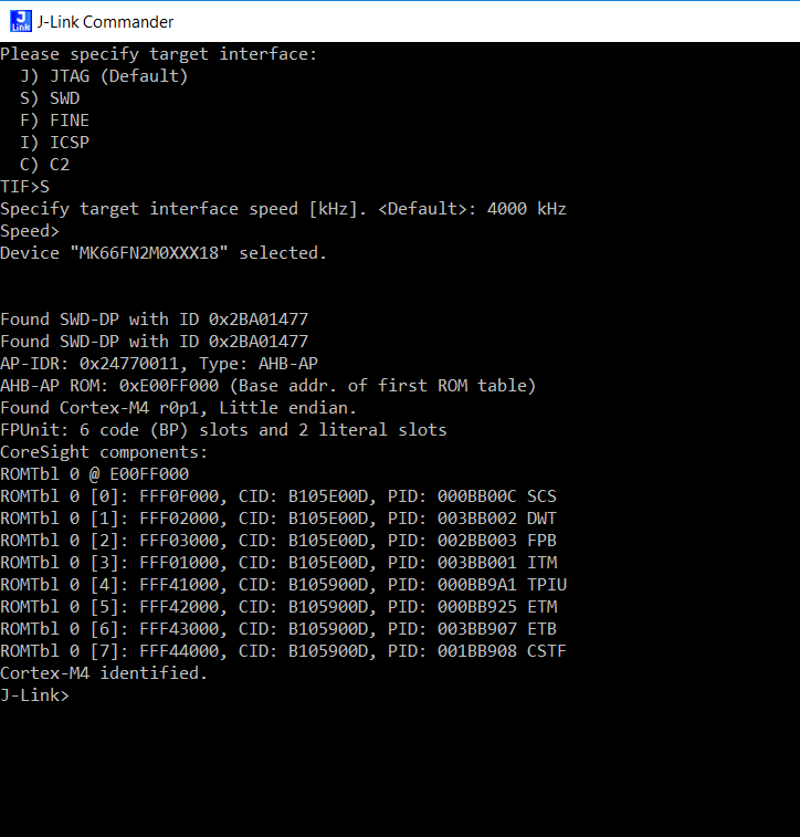

kumarnarendrasi
Hello Kerry,
Yes Cortex-M4 is identified
But for K20 device is not identified. I have JTAG interface for K20.  please find the Image below.

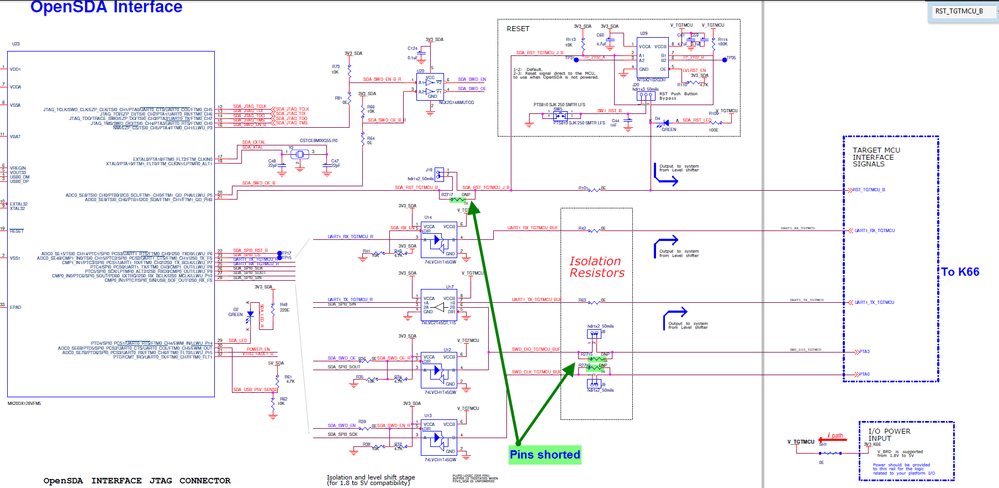

We probed the signals from K20 to K66 and found that K66's(MK66FN2M0VLQ18) RESET{isolated by a Jumper}  is controlled by K20's SDA_RST_TGTMCU_B , K20 is always keeping this line low only when I upload a bin file to the K20's Storage(FRDM-K66FD) and remain always at the same state (LOW).

kerryzhou
Hi Raj,
    Good, so we can know, actually, your problem is just in the K20 side, not the K66 side.
    Normally, this problem is caused by the hardware.
    You can check the K20 smallest system solder, any solder problem in the K20 pin? Please check it carefully.
    If you can't find the problem, I recommend you try to change another K20 chip, then note the solder temperature, the max solder temperature is 260°C, too high solder temperature may damage the chip.
  Please try it again on your problem board.
Kerry

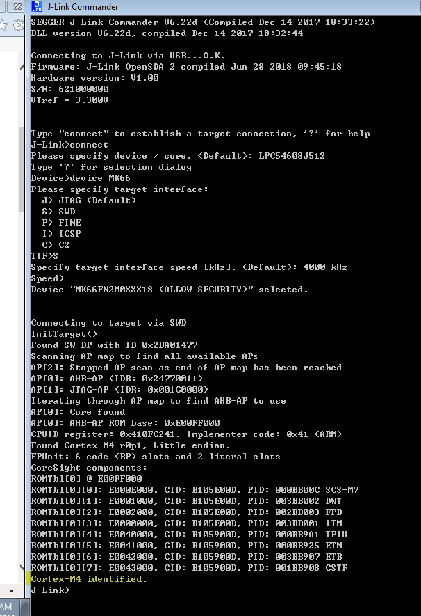

kerryzhou
Hi Raj,
    Thanks for your updated information.
    Now, let's just test your "Not working boards".
    Please change the Not working boards debugger to JLINK, then open the JLINK commander, try to connect your own board K66 chip, can you find the core?
  You can try it, whether you can find the core or not like me?
Kerry
