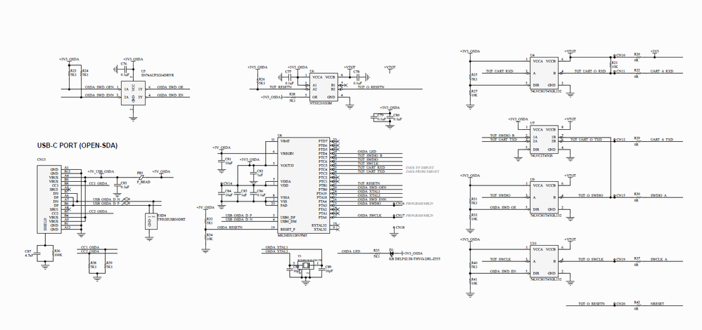

Hi, we're having this issue trying to program MK20 for OpenSDA;
After programming the reset pin is outputing pulses which according to various other posts here means the chip did not program correctly but the J-Flash Lite and J-Link Commander seem to report otherwise.
Another think to poing out is that J-Flash lite wrote the message of the MCU being protected and that I needed to do a full chip erase which was the case every time I tried to program it.
Here's the schematic:
Here's the reset pin:
And here's the J-Link commander text:

Hello ,
Hope you are doing well.
From your log it looks to me that you are downloading the firmware on address 0. However, this is where the bootloader should be. You need to first download the first binary located on the OPENSDA page.
This will be in address 0. Once that is downloaded you will be able to drag and drop the firmware as described in the page as well, then consequently be able to work with your board.

THank you very much, that helped!
