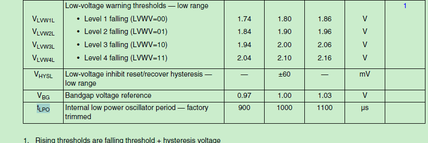

I am also thinking we could use the 1kH LPO for the sleep clock but not sure it can do 250mS. This can be utilised with the internal wdog?
We don’t need super accuracy but the 1kHz clock has +/-10% accuracy and it is pretty bad. So I am wondering whether we could calibrate the 1kHz. May be another way?

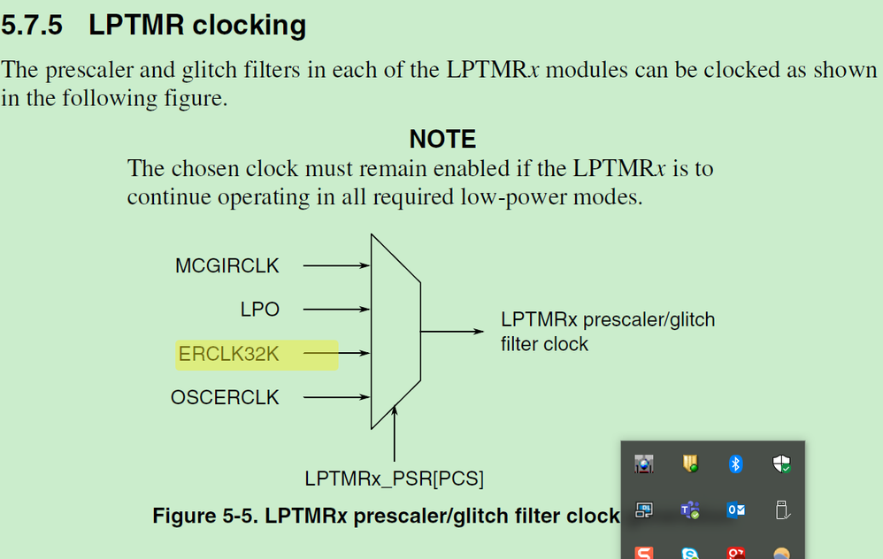

    Then you want to use the LPTMR as the timer to wake up from the VLPS, right?
     LPO 1Khz is defined, and can't be calibrated.
But I think you can use ERCLK32K:
Because already add the external 32K crystal, you can use it.

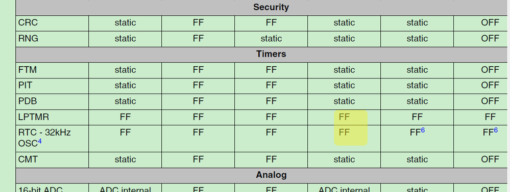

The LPTMR0 is used in the main full run and are we able to use this during sleep?

  Check the RM, chapter 7, you will find LPTMR0 works in VLPS mode, LPTMR is the low power timer.
Before you enter the VLPS mode, set your LPTMR timer interrupt to 250ms, then enter the VLPS, after 250ms, the LPTMR interrupt will happens and wake up the VLPS directly.
