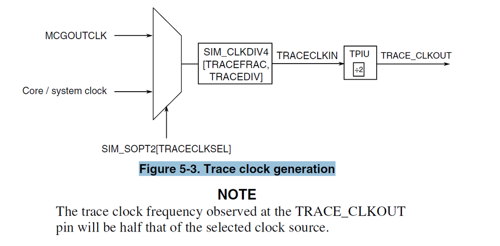

My target is an MK10FN1M0VLQ12. I’ve tried using two clock options; a 25 Mhz oscillator to XTAL0 ->PLL0 with a 100Mhz and 60Mhz and the internal clock with 41,943Mhz.
I have measured the TRACE_CLKOUT at PTA6:
SIM->SOPT2 |= SIM_SOPT2_TRACECLKSEL_MASK
SIM->SCGC5 |= SIM_SCGC5_PORTA_MASK;
PORTA-> PCR[6] = PORT_PCR_MUX(0x7) | PORT_PCR_DSE_MASK;
The Trace_CLKOUT shall be half of the core clock.
When the external clock is configured to 100Mhz the Trace_CLKOUT is 25MHz.
When the external clock is configured to 60Mhz the Trace_CLKOUT is 15MHz.
Also when the internal clock is configured to 41,943… Mhz the Trace_CLKOUT is 10.333MHz.
The external clock configuration:
25Mhz * (VDIV=24/ PRDIV=3)/2  = 100 Mhz and 25Mhz * (VDIV=24/ PRDIV=5) / 2 = 60Mhz
What is wrong with? My Uart gives me only gurba. When configuring the UART BDL (baud rate) according to measured value the UART gives me gurba as well. I’m using the KEIL ide.

I haven't done anything with K10/ 120MHz, however I have a clue in
SIM_CLKDIV4 field
Divider output clock = Divider input clock * ((TRACEFRAC+1)/(TRACEDIV+1))
defalut values are TRACEFRAC=0 and TRACEDIV=1
which defaults into
Divider output clock = Divider input clock * 0.5
Pavel

probably you're missing the fixed by 2 divider at the PLL output? here's a post I seems similar to what you experiencing:
https://community.freescale.com/thread/310897

Did not miss the Fixed Divider:
25MHz * (24/3) /2 = 100 MHz MCGCLKOUT. Trace out: 25MHz

mrandreas
Ok thanks, so the measured TRACE_CLKOUT is correct since MCGOUT/4. But then I can’t understand why my UART1 is giving me gurba and why Keil Logic Analyzer shows that the systick interrupts every 10 ms instead of 1 ms.
How can I debug this?
