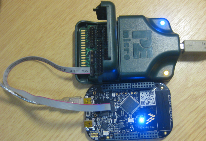

Hello,I'm trying to debug my kl26z board by using SWD (sth like) :
SWD Debugging with the FRDM-KL25Z Board | MCU on Eclipse
I'm using PE MICRO USB Multilink Universal.

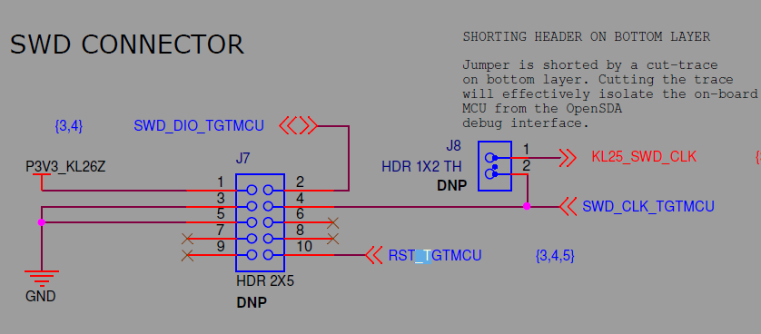

My connections:
TVCC - P3V3_KL26z
TMS - SWD_DIO_TGTMCU
TCK - SWD_CLKTGTMCU
RESET - RST_TGTMCU
and GND- GND
SWD connector from kl26z board:
SWD connector from multilink universal:
I power my board fromKL26z USB connector (not from OpenSDA USB port).
exactly like on this picture:

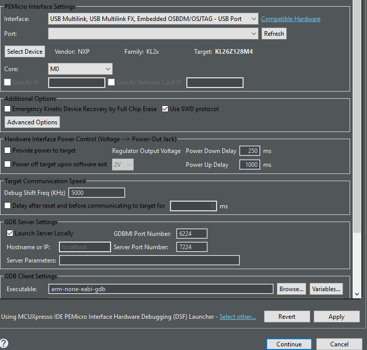

My debugger configuration:

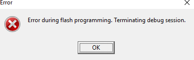

And if I try to debug my board, I have this error:
Is there any solutions?

johnny_pe
Hi Bony,
The PEMICRO settings dialog in the debugger configuration shows that you don't have an assigned USB port for the Multilink Universal. Please try pressing the Refresh list button.
It might be that your USB port is locked out due to another open PEMicro application or MCUXPRESSO process.
Johnny
PEmicro Support
2,988 Views
BlackNight
Your debugger configuration shows that you don't have a USB Port assigned for your probe connection?
