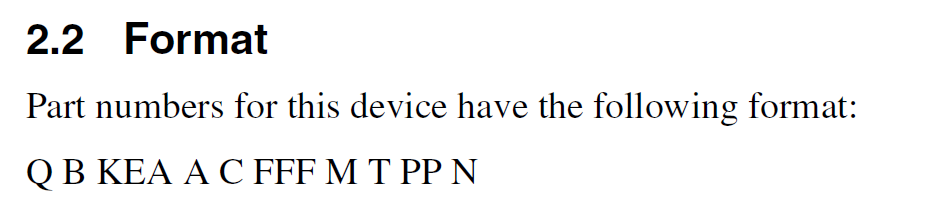

Hello omar,
- No, other latters also need care, for example the "MLK " indicate the 80 pin,
for the meaning of the part number you can refer to the "S9KEA128P80M48SF0.pdf"
- While all of the SKEAZ128 chip select the ""SKEAZ128".

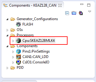

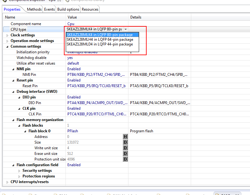

After you create the PE project on CW, you can change the chip at here :
on the board of TRK-KEA128, the chip is :
Alice Yang
