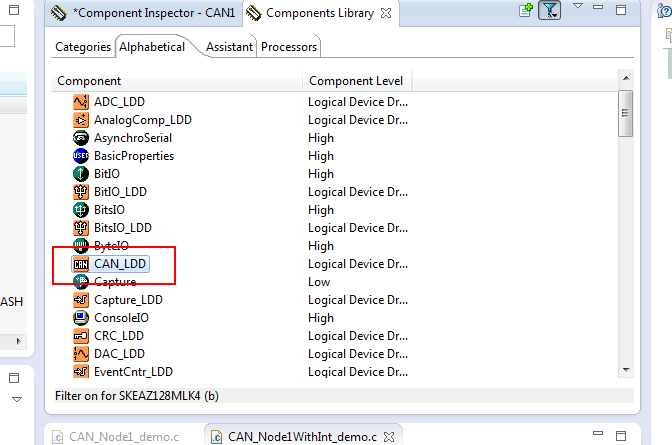

omarzamacona
Hello Alice,
Just to say thank you for your help.
Regards!

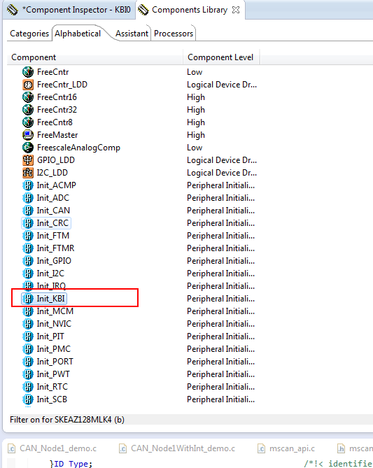

omarzamacona
Hello Alice,
Looks very nice, thanks!
Do you know how or why I can´t access to the full Library in Processor Expert?
I want to add a KBI component but I not able to do it. In fact KBI component is not listed. and when I used the examples included on the KEA kit (CD-ROM) these "hidden" components are visible, why?
Regards!
7,091 Views
Hello omar,
Do you mean this one
if not , please take a screenshot about that component to me .
Hope it helps
Alice

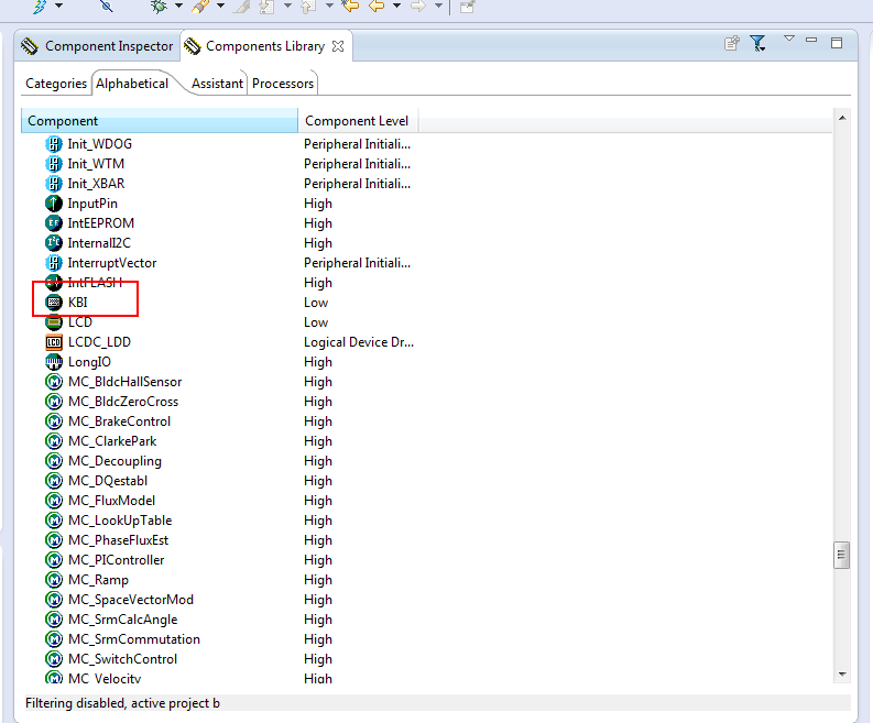

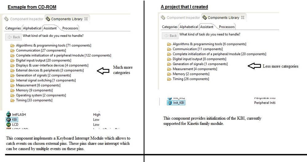

omarzamacona
Hello Alice.
I´m thinking, maybe, the problem could be at the time when the project is created. I´m not sure why I can´t see the full library as in the CD-ROM example, one of the components that I can´t see is the KBI (just "KBI"). Please see the image attached. Thanks!

Hello omar,
When you click the button of  this pastedImage_0.png, it will show all of the components , also the "KBI"
While this is meaning all of the components for all of the chips , not only for the KEA128, while the KBI component
can not used on KEA128 chip, and this button pastedImage_4.pngis used show the components available for the chip we used(when it
is pressed  ).
Hope it helps
