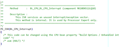

Can anyone please help me with the location where I can download processor expert v10.2. On NXP  website I can only find v10.4.
uC = MK10DX256VLQ10 on custom

In the CPU setttings, change the interrupts to 'one for every' (see https://mcuoneclipse.com/2012/02/20/oh-my-an-interrupt/ ) so you know which interrupt was firing.
I hope this helps,
Erich

is there a specific reason to use the 10.2 instead of the 10.4? I have switched long time ago to 10.4 and did not see and drawbacks compared to 10.2.
I believe if you download the 10.4, you will find the 10.2 in 'previous versions' on the web interface.
Erich

da_vinci
Hello @ErichStyger
I have a .out that was created using v10.2 and when I build the same using v10.4 I am getting significant size difference in the output (v10.4 has increased the size)
Every time I halt the debug session pointer stops at this ISR
So I wanted to see if the problem is in the code or processor expert version

ErichStyger
Specialist I
I hope this helps,
Erich

da_vinci
I'll check this out. Thanks!
