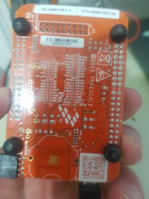

Secondly, how the customer can check which REV EVK he got (see his kit below)?

Regarding what you have asked for, may you tell me what do you mean with "the code seems to be broken"? Because examples from our SDK are well developed to work properly. Did you try running frdmkl82z_dspi_polling_b2b_transfer_master with another SPI device (as slave)? instead of using other evk board as slave.
Lastly, your question about REV EVK, you can see in the top right corner the SCH number and Rev. for that, so you can check the schematic from that board right here: https://community.nxp.com/pwmxy87654/attachments/pwmxy87654/kinetis/33535/1/SPF-28889_B.pdf

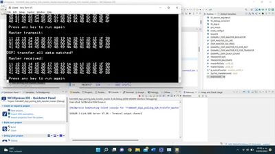

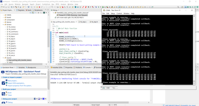

PabloAvalos
Hi @shai_b
Thank you so much for your patience and for your reply.
After double-checking the SDK examples that we talked about with a frdm-kl82z and one frdm-k64z (that actually has a similar EVK pinout), the examples run successfully and work very well, so I would like to suggest you to check connection between the two EVKs, please.
Here are my results and connections done:
Please let me know if you have more questions.
Thank you.
Best Regards.
Pablo Avalos.

PabloAvalos
Hi @shai_b
Thank you so much for your reply.
Regarding the PINs for the SPI demo, they are the pins available (arduino compatible) that are mapped to the SPI0, and as demo example use SPI0, they are the PINs that you need to connect to run succesfully the Demo.
The code that I used for slave was dspi_polling_b2b_transfer_slave.c SDK example 2.5.0 version that you can download from here, selecting frmd-kl82z: https://mcuxpresso.nxp.com/en/select
The code that I used for master was dspi_polling_b2b_transfer_master.c SDK example 2.11.1 version, for frdm-k64f, but at the end, both boards manage the same pinout for SPI0 and examples from SDK are pretty similar and working succesfully.
Please let me know if you have more question, I will be happy to assist you.
Best Regards.
Pablo Avalos.
