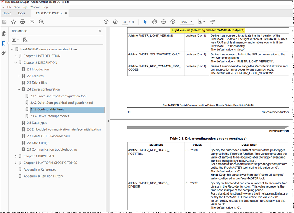

Have you tried Light version (achieving smaller RAM/flash footprint)?

Dear sir,
               I still got that error even after changing to light version. Attached image for reference.
I changed FMSTR_REC_OWNBUFF to 1, There are NO errors.
