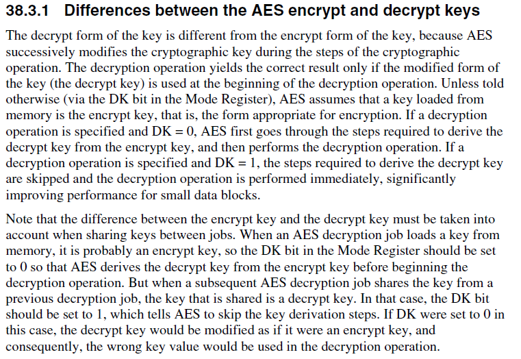

I think maybe there is some thinking set or mind-set when we read these lengthy and uncommon sense words. Let us describe the keynote when do a decrypting.
 Is the key encrypt key?(yes) --> We should derive a decrypt key!--> Keep DK zero --> AES derive a decrypt key
Yes, set DK to 1 means skipping the derive step.
But there is no word say what decrypt key looks like.
Jing

The decryption key is derived from the encryption key and needs to be performed as a step before usage. For example in the embedTLS library it is performed by calling aes_setkey_dec().
The LTC does this step as an integral part of its decryption function (if DK is 0) and the derived decryption key can be seen in the module's key registers after the step.
When DK is set to 1 it essentially tells the module that it should skip this step because the decryption key (and not the encrypt key) is (already) in place.
I don't think that the decrpt key is usually of general interest (that is, how it looks) but I suspect that in both cases it could be read back and saved. Then it could be directly loaded (in case of the LTC to its key registers and in the case of the SW implementation to its key buffer in its instance) and thus the conversion step be saved when it is used again -> speed improvement against need to backup the values. Whether there is great interest in this (slight) optimisation is another question. I will measure the LTC decryption speed with a primed decrypt key against its speed when it needs to do the conversion at some point and let you know....

DK must be set "before" (or while) the key is entered otherwise the module will think it is an encrypt key and so it will fail when decrypting.

If the key is same as encryption, you should not set DK.
In ltc_aes_cbc_exam()
   status = LTC_AES_DecryptCbc(base, cipher, output, g_length, ive, key128, AES128_KEY_SIZE, kLTC_EncryptKey);
And in  LTC_AES_DecryptCbc()
   if (keyType == kLTC_DecryptKey)
        base->MD |= (1U << kLTC_ModeRegBitShiftDK);
Jing

Also I re-read the description for about the 6th time and finally it starts to make sense:
Basically, if DK is set it means one is passing the decrypt key (and not the encrypt key). The LTC can work with the encrypt key by doing a decrypt conversion when needed (takes longer than if the decrypt key is supplied directly).
Interestingly in another post I was finding that the second decrypted block was successful when using the DK setting (setting encryption key and informing that it were the decrypt key) which suggest that after the first block decryption (failed) it was internally converting the key to a decrypt key (presumably as a part of the normal decrypt operation...).....
