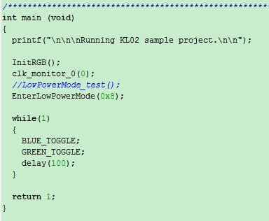

Hui_Ma
I don't think place EnterLowPowerMode(0x8) in a while loop will make any difference.
Please check below test result, which I using below code:
When the EnterLowPowerMode(0x8) function was called, the KL02 will enter into VLLS3 low power mode.
The wake up process from VLLS3 likes a chip reset, so the code will execute from the start() function of <start.c> file.
There with no difference to place EnterLowPowerMode(0x8) function out of the while loop.
Please check attached video record about the test result.
Ma Hui
