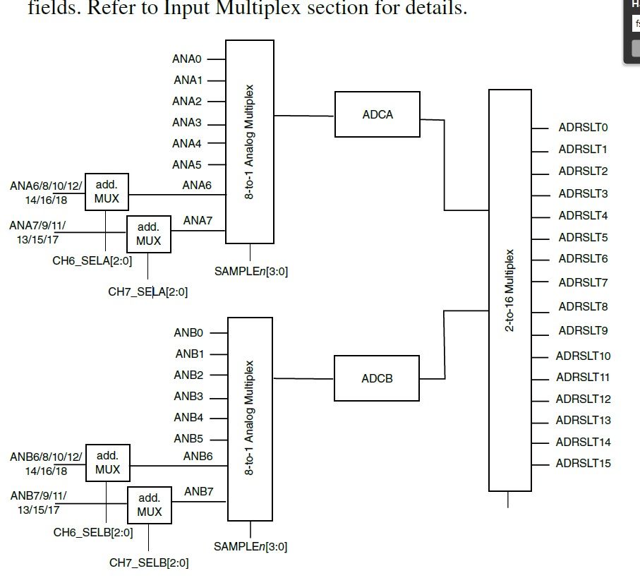

Good day
I use MKV58F1M0vl24 in the case of QFP100
I need to use the second HSADC0 multiplexer and channels from 6-12 and the corps leads 28,21,20,19,18,15,14 which are not ports of input-output. As is known, the inputs of HSADC0 from 6-channel and further multiplexed by the HSADCx_MUX67_SEL register. And I'm using a non-differential input mode. External reference voltage source 3V. Power of VDDA 3.3V. A quartz oscillator 25MHz for clocking is external used. The core frequency is 200 MHz.
The problem is the following when I try to convert from inputs number 6 and more values are obtained not true and when at input 0V (input is closed to ground) the value does not drop to 0 it can be about 0x200. Also, if a 2000 ohm resistor is connected to the input by one contact and the second one is connected to the ground at the input, there is a voltage of about 2.5V. Conversion from inputs 0-5 is excellent and correct. I took an example from KDK2.0 on the work of HSADC0 changed the channel numbers to the ones I needed to set up the settings for my kernel clock and HSADC0 mode. Maybe you can tell me something?

Hi, Konstantin
I suggest you pay attention to the two tricks:
If the analog pins is multiplexed with GPIO, pls use the code to set the pin as analog pins:
For example, PTE1 and PTE2 are multiplexed with ADC0B_CH10 and ADC0B_CH17, you have to use the code to intialize.
    CLOCK_EnableClock(kCLOCK_PortE);
    PORT_SetPinMux(PORTE, 1u, kPORT_PinDisabledOrAnalog);
    PORT_SetPinMux(PORTE, 2u, kPORT_PinDisabledOrAnalog);
2)check the HSADCx_MUX67_SEL register if it is set up correctly.
3)if you use parallel mode, you have to follow up the sequence:
converterA:sample0/sample1/sample2........
converterB:sample8/sample9/sample10.....
I have tested the hsadc_dual_parallel_conversion_twrkv58f220m, I think the ADC samples are correct.

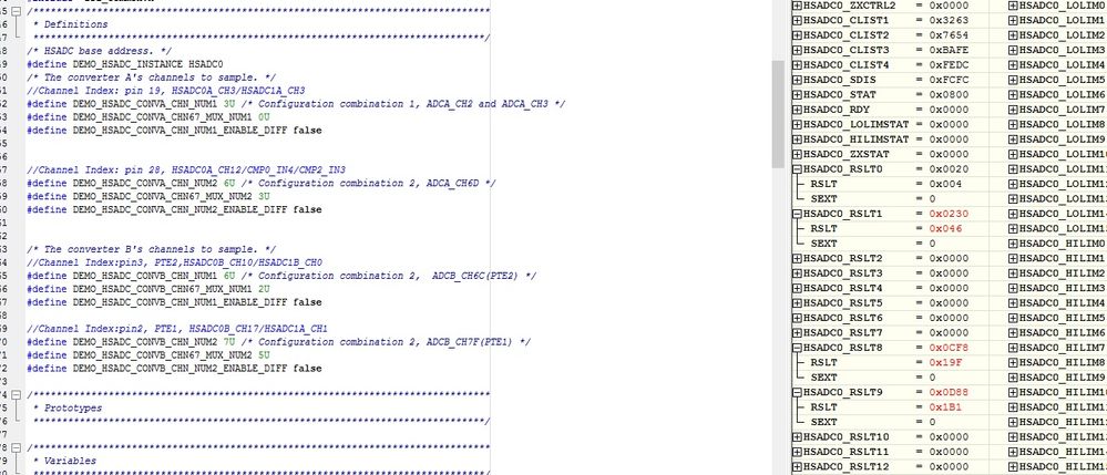

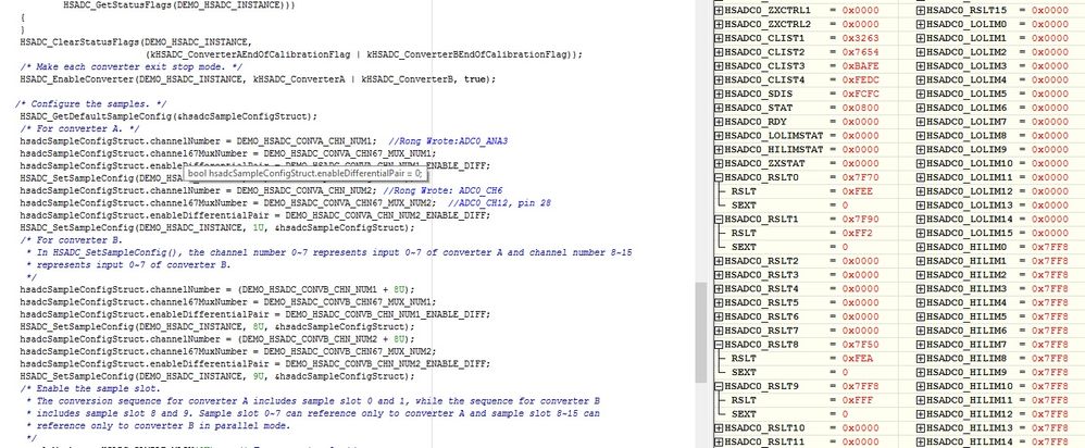

konstantinivano
Good afternoon Xiangjun Rong
I set your settings but changed ADC0A_HC3 to signal type not differential. I also closed all contacts on 2.3.19.28 on AGND or VREH received such data after conversion (see photo). I use my VREFL processor contact board is shorted to AGND and the VREFH contact is closed to the 3.0V reference voltage source of the qfp100 processor case. How do you think it can be wrong to calibrate if the input voltage is applied immediately? What tests do you need?AGND.jpgVREFH.jpg

hsadcSampleConfigStruct.channel67MuxNumber = DEMO_HSADC_CONVA_CHN67_MUX_NUM1;
hsadcSampleConfigStruct.enableDifferentialPair = DEMO_HSADC_CONVA_CHN_NUM1_ENABLE_DIFF;
HSADC_SetSampleConfig(DEMO_HSADC_INSTANCE, 0U, &hsadcSampleConfigStruct);
hsadcSampleConfigStruct.channelNumber = DEMO_HSADC_CONVA_CHN_NUM2; //Rong Wrote: ADC0_CH6
hsadcSampleConfigStruct.channel67MuxNumber = DEMO_HSADC_CONVA_CHN67_MUX_NUM2; //ADC0_CH12, pin 28
hsadcSampleConfigStruct.enableDifferentialPair = DEMO_HSADC_CONVA_CHN_NUM2_ENABLE_DIFF;
HSADC_SetSampleConfig(DEMO_HSADC_INSTANCE, 1U, &hsadcSampleConfigStruct);
/* For converter B.
* In HSADC_SetSampleConfig(), the channel number 0~7 represents input 0~7 of converter A and channel number 8~15
* represents input 0~7 of converter B.
hsadcSampleConfigStruct.channelNumber = (DEMO_HSADC_CONVB_CHN_NUM1 + 8U);
hsadcSampleConfigStruct.channel67MuxNumber = DEMO_HSADC_CONVB_CHN67_MUX_NUM1;
hsadcSampleConfigStruct.enableDifferentialPair = DEMO_HSADC_CONVB_CHN_NUM1_ENABLE_DIFF;
HSADC_SetSampleConfig(DEMO_HSADC_INSTANCE, 8U, &hsadcSampleConfigStruct);
hsadcSampleConfigStruct.channelNumber = (DEMO_HSADC_CONVB_CHN_NUM2 + 8U);
hsadcSampleConfigStruct.channel67MuxNumber = DEMO_HSADC_CONVB_CHN67_MUX_NUM2;
hsadcSampleConfigStruct.enableDifferentialPair = DEMO_HSADC_CONVB_CHN_NUM2_ENABLE_DIFF;
HSADC_SetSampleConfig(DEMO_HSADC_INSTANCE, 9U, &hsadcSampleConfigStruct);
/* Enable the sample slot.
* The conversion sequence for converter A includes sample slot 0 and 1, while the sequence for converter B
* includes sample slot 8 and 9. Sample slot 0~7 can reference only to converter A and sample slot 8~15 can
* reference only to converter B in parallel mode.
sampleMask = HSADC_SAMPLE_MASK(0U) /* For converter A. */
| HSADC_SAMPLE_MASK(1U) /* For converter A. */
| HSADC_SAMPLE_MASK(8U) /* For converter B. */
| HSADC_SAMPLE_MASK(9U); /* For converter B. */
HSADC_EnableSample(DEMO_HSADC_INSTANCE, sampleMask, true);
HSADC_EnableSample(DEMO_HSADC_INSTANCE, (uint16_t)(~sampleMask), false); /* Disable other sample slots. */
PRINTF("Press any key to trigger the conversion ...\r\n");
PRINTF("\r\nSample 0\tSample 1\tSample 8\tSample 9\r\n");
while (true)
PRINTF("\r\n");
/* Trigger the converter.
* Trigger converter A would execute both converter's conversion when in
* "kHSADC_DualConverterWorkAsTriggeredParallel" and simultaneous work mode.
/// GETCHAR();
HSADC_DoSoftwareTriggerConverter(DEMO_HSADC_INSTANCE, kHSADC_ConverterA);
/* Wait the conversion to be done. */
while (kHSADC_ConverterAEndOfScanFlag !=
(kHSADC_ConverterAEndOfScanFlag & HSADC_GetStatusFlags(DEMO_HSADC_INSTANCE)))
/* Read the result value. */
if (sampleMask == (sampleMask & HSADC_GetSampleReadyStatusFlags(DEMO_HSADC_INSTANCE)))
PRINTF("%d\t\t", (int16_t)HSADC_GetSampleResultValue(DEMO_HSADC_INSTANCE, 0U));
PRINTF("%d\t\t", (int16_t)HSADC_GetSampleResultValue(DEMO_HSADC_INSTANCE, 1U));
PRINTF("%d\t\t", (int16_t)HSADC_GetSampleResultValue(DEMO_HSADC_INSTANCE, 8U));
PRINTF("%d", (int16_t)HSADC_GetSampleResultValue(DEMO_HSADC_INSTANCE, 9U));
HSADC_ClearStatusFlags(DEMO_HSADC_INSTANCE, kHSADC_ConverterAEndOfScanFlag);
