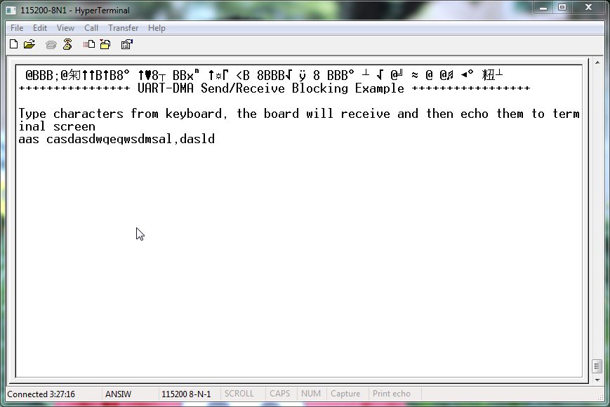

Hi Andrejs,
I did a similar test on TWR-K22F120M board with the demo of uart_edma_blocking out of ksdk 1.3, it works well with RXEDGIF interrupt enabled. Please refer to the following for details.
so I think it might be a software issue, the following is the interrupt service for UART1, so far I just clear the RXEDGIF flag in it, is it the same as your code?
void uart1_rxegif_int()
  if(UART1_S2 && UART_S2_RXEDGIF_MASK)
    UART1_S2 |= UART_S2_RXEDGIF_MASK;
Kan

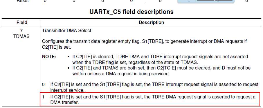

Hello And,
Does the data need to be transfer by DMA is  the UART data ?
If yes , i think you can use the UART trigger a DMA request .
Hope it helps
