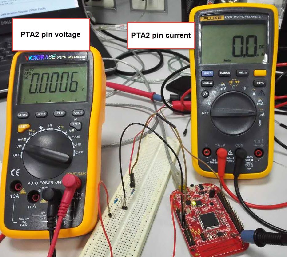

Sorry for the later reply.
I do a test with FRDM-KE02Z board using your external circuit (using 10K pull up resistor, 220K serial resistor with 1nF capacitor).
When I set the PTA2 as GPIO input function, the current is 0uA and Voltage is 0V.
Please check below picture for the detailed info.
I connect the place button2 directly to the board GND.
So, I suggest you could conntect button2 directly to the GND and check the PTA2 voltage and current.
Wish it helps.
Ma Hui

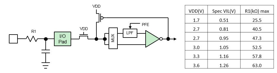

The problem isn’t the current at level hi or low, it is between these levels. You can see that at the measuring documentation. I do drive the button2 with a signal generator und do measure both end of the serial resistor. I think that the I2C0 make this problem, although he isn’t enabled.

Hui_Ma
Hi John
The serial resistor is too high, the pin level will not drop below VIL which is needed to turn off the p-channel keeper.
Please refer below picture, the serial resistor R1 must be low enough such that the PFET current will make this IR less than VIL when signal is grounded.
In general, use 20uA to calculate the initial R1 value and pick lower value.
If using the internal pullup, the R1 value should be less than 10kΩ (internal pull up resistor is about 30kΩ~50kΩ).
Wish it helps.
Ma Hui
