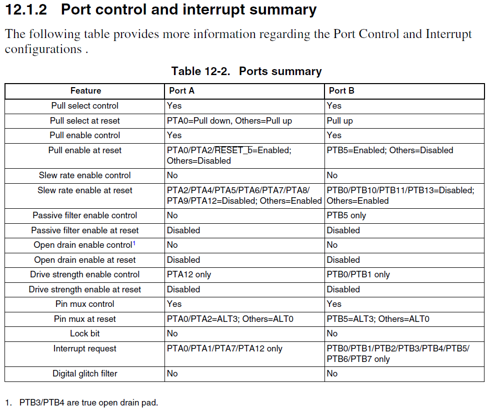

Below is the pin overview showing nothing special for PTA3 and PTA4; there is no relation between mux setting and characteristic.
It is probably purely an electrical issue.

You need to check the configuration of the chip that you are using. The feature set varies between parts but each user manual has a list of the features and defaults of each pin so this is best used as reference when starting.
Generally, features such as pull-ups/downs, driver strength etc. are valid for whatever peripheral function has been selected (eg. one can choose to have a UART RXD line with or without pull-up or what slew-rate and drive strength its UART TXD has).
Don't rely on automation tools since they are only as good and accurate as set up by a anonymous person so I would prefer to invest a few minutes to be sure rather than rely on chance and later lose time and expense in case you get unlucky.
Beware that some ports on the KL03 are true open-drain so need external resistors. The uTasker KL03 project signals this in its KL03 emulation as shown below to help users not overlook the detail.

We are using ports A3 on pin 5 and A4 on pin 6. I am not sure what uTasker is, but from your screen shot it appears that there is no "^" but a "P" for those pins.  My assumption is that "P" designates a normal port pin with pull up resistor capability even if that pin is disconnected from GPIO and reconnected to I2C.  But when we (thought we) activated the pull enable and the pull ups for A3 and A4 we did not see any difference in the I2C activity (still looked like noise).  After adding external pull up resistors as Kerry Zhou recommended the I2C activity appeared normal.
Where in the KL03 specifications are there indications that pull up resistors are available for a particular pin and for a particular MUX setting?

Ah, so because A3 and A4 are not listed in chapter 12, it can be inferred that they behave "normally".  That is, they should have pull up / down capability.  Well, it didn't look like they did when I turned it on / off in the software.  But as Kerry Zhou points out, they are weak.

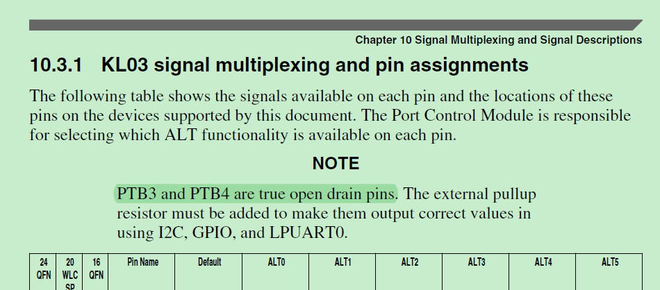

kerryzhou
Hi Rick Stuart,
   Which pin you are using as the I2C function?
   From the reference manual, you can find PTB3, PTB4 is the true open drain pin, so you must add external pull up resistor, normally, add 10K pull up.
Please add the external pull up, then try again.
