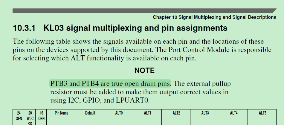

kerryzhou
Hi Rick Stuart,
   Which pin you are using as the I2C function?
   From the reference manual, you can find PTB3, PTB4 is the true open drain pin, so you must add external pull up resistor, normally, add 10K pull up.
Please add the external pull up, then try again.
Kerry
