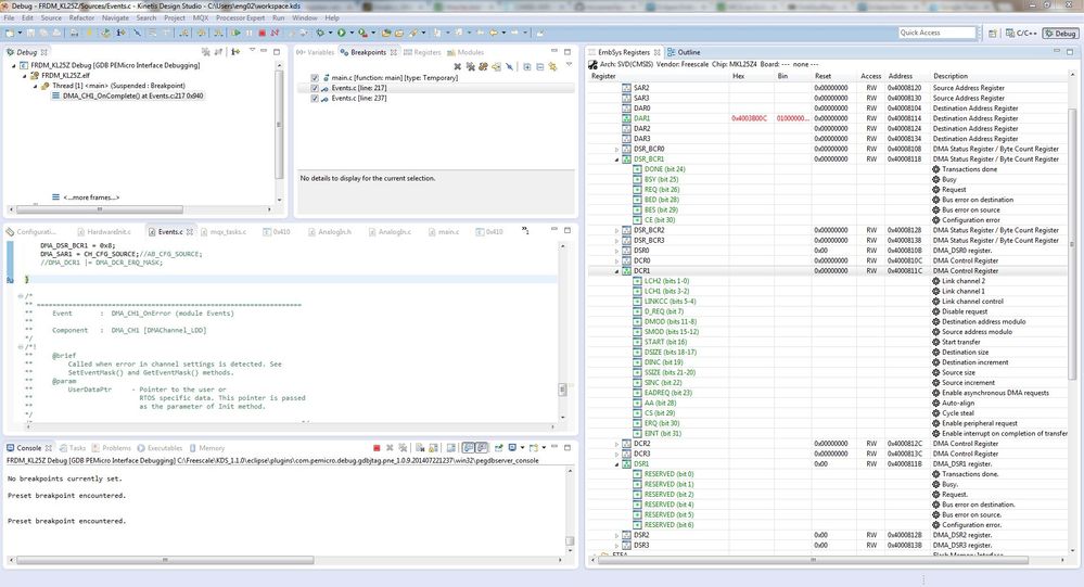

Hi all,
I'm using KDS to program the DMA of KL25Z.
I'm setting the DMA to transfer a few configurations to ADC registers. DMA is triggered by hardware request (TPM0_CH1).
When the transfer complete event is called, the BCR is reset to the initial value and the SAR to begining of the config vector. But just 1 transfer (cycle steel of 8 bytes) can be completed, after this the DMA just call the OnError event.

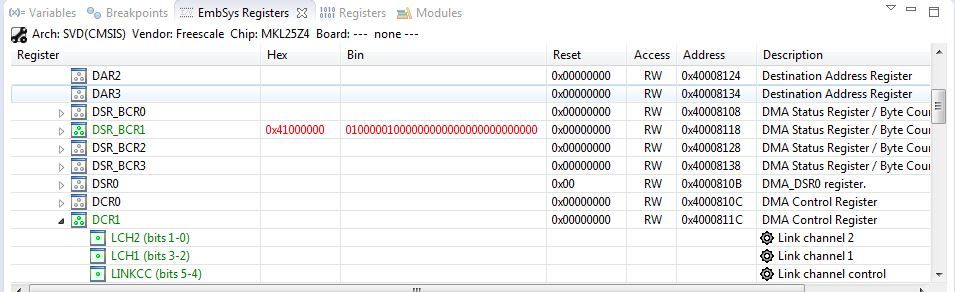

To see what's happening I've installed the EmbSysRegView (How to Add Register Details View in Eclipse | MCU on Eclipse). By setting a break point at the DMA_Error event, I saw the BCR register comes to this value:
I don't know why, because the value that I put on this register is 0x8.
This is my code:
void DMA_CH1_OnComplete(LDD_TUserData *UserDataPtr)
  printf("\nch1 dma complete");
  DMA_DSR_BCR1 = (uint32_t)8;
  DMA_SAR1 = AB_CFG_SOURCE; //Macro definition of the source address
Anyone knows whats happening?

DSR_BCRn is signalling that a configuration error occurred (0x40000000). This means that maybe the first transfer was successful but futher not due to an error (invalid source or destination is typical).
For example an attempt to read a long word from a non-aligned address would cause this, or writing to an invalid address.

wendersonolivei
     I set a breakpoint at the end of OnComplete event, after the new configuration. But, only one register have your value shown here.
     That's the problem. With this viewer is very hard to debug correctly.
