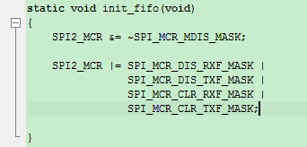

I do a test with K60_100MHz DSPI module and check when write a byte to SPI_PUSHR register how many bytes the SPI will transfer. The result is only one.
Please refer below code to disable TX/RX FIFO and Clear TX/RX counter during SPI initialization.
And it need to set SPIx_CTARn register [FMSZ] bits value to 0x7 for a byte data transfer.
The test software source code is based on spi_demo from below link:
KINETIS512_V2_SC  (Kinetis 100MHz Rev 2 Example Projects):
Kinetis K60 100 MHz MCU Tower System Module|Freescale
Wish it helps.
