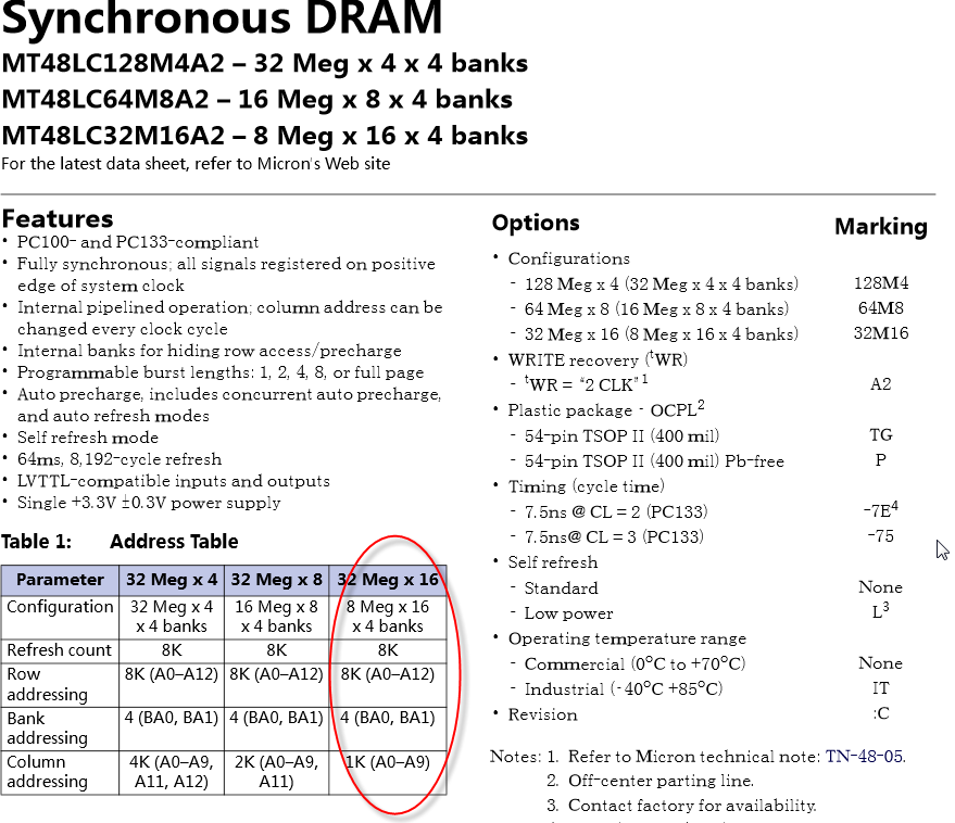

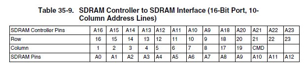

Is it possible to connect the MCU MK65 to SDRAM MT48LC64M8A2? SDRAM has 8192 rows by 2048 columns, 10 columns A[9:0] SDRAM can be connected to A[16:9], A[22:20], A18 of MK65FN2M0VMI18, which is described in table 35-9 K65P169M180SF5RMV2.pdf. But on the page 890 is "The maximum SDRAM address size is 128 Mbits" and I want to connect SDRAM 512Mbit (64MB). Isn't this limit determined only for FlexBus and SDRAM can exceed this limit?

I checked the data sheet of MT48LC64M8A2, and looks like you are going to use the following configuration in red circle with table 35-9 , right?

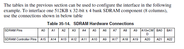

If yes, I think maybe you have ignored the BA0 and BA1, which should be also listed as two of the address lines, such as table 35-14
so if you connected in the way of table 35-9 shown, only 128Mbit can be accessed with predefined states on BA0 and BA1, it is not a limitation for flexbus, but for SDRAM mapping.

you're right, I forgot that bank adresses BA0, BA1 should have been connected to GPIOs and switch banks manually.
