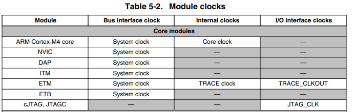

smathad
Hi Kerry,
Thank you for your response.
I did find that table helpful.
Can you please let me know the difference between bus interface clock, internal clock and I/o interface clock in that table?
Sachin
3,899 Views

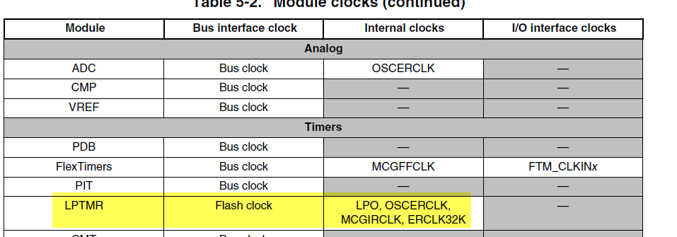

kerryzhou
Hi Sachin Mathad,
  You are welcome!
   Bus interface clock, you can consider the related module register control clock.

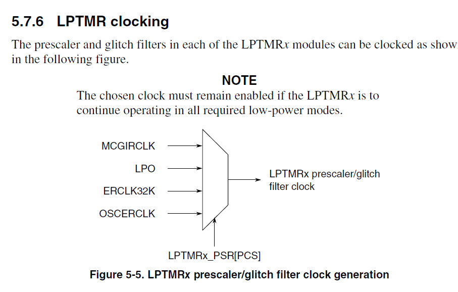

   Internal clocks, you can consider it as the module clock, now take LPTMR as an example
You can find the LPTMR internal clocks is the module clock.
 I/o interface clock is the clock which is input or output to the related IO pins.
Wish it helps you!
If you still have questions about it, please kindly let me know.
Kerry
