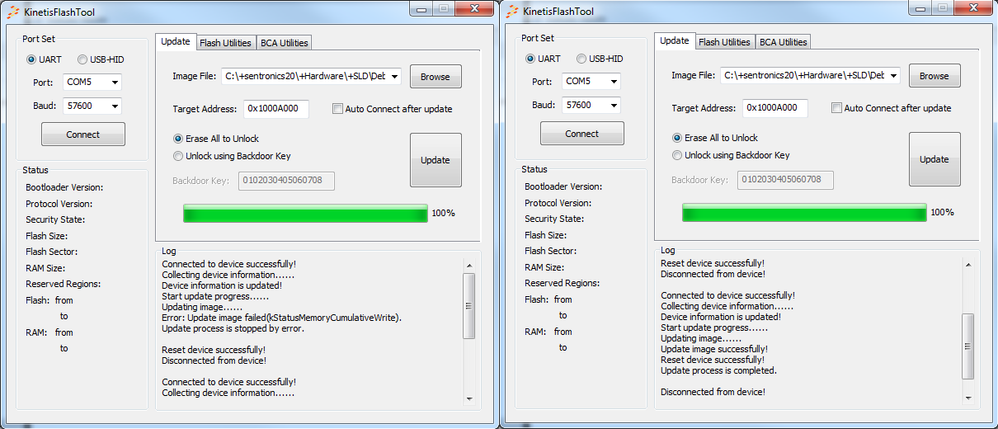

Hi all,
I successfully ported the KBOOT V2 from the TWR-MKV58F22 Bootloader to my MKV58F1M0VLL24 MCU on a custom board (Using KDS V3.2). Neraly everything is working as expected, except a strange update-behaviour with the KinetisFlashTool.
Updating my application binary to the target address sometimes succeeds and sometimes fails with the kStatusMemoryCumulativeWrite errormessage. I observerd this behaviour especially then, when there is already an application binary on the target flash, which I am going to erase and replace with my new application (in my example, the new application binary is the same binary as the one already placed on the flash... I just want to test everything to avoid later upcoming bugs, so the content of my binary shouldn't be of interest). When the error message occurs, I try to erase the whole flash memory in order to prevent cumulative memory writing as mentioned in the MCU's reference manual. Since now, every time I erased the whole memory, the KinetisFlashTool just responded with "Erase all memory of internal flash. Completed!", so I expected the erasing to be successful.
Nevertheless after trying to Update my "new" application binary to the "freshly erased flash memory", the same cumulative write error occurs. The only workaround for this problem is to reset the device via the KinetisFlashTool followed by normally clicking the Update Button...
After this procedure, when I reset the device, connect to KinetisFlashTool and try to Update the application binary again, the already mentioned error occurs again. And again, erasing the whole flash memory doesn't help at all.
Since I didn't found any similar question about this, I am wondering if I am missing any important step while updating my application binaries?
I would really appreciate some help to understand what is going wrong with the updating procedure on my MCU...

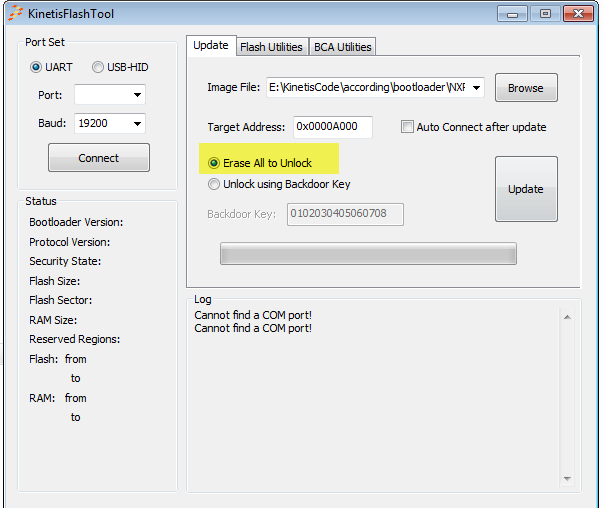

Hello Julian Schork,
    When you use the KinetisFlash Tool, please select the erase all to unlock, just like the following picture:
  Then try it again.
If you still have problem, please also attach the problem picture about your kinetisFlash Tool.
Kerry

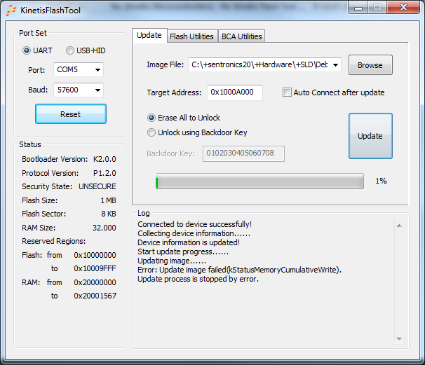

Unfortunatelly using the "Erase All to Unlock" Feature doesn't solve the problem. As mentioned before, even erasing the whole memory (starting from application address) before updating my binary doesn't solve this issue. I attached a screenshot of the Kinetis Flash Tool where the error occured.Flash Tool Error.png
Restarting the device via the "Reset" Button in the Kinetis Flash Tool solves the issue for the moment, but the next time I am trying to update my binary, the same error occurs. Additionally, closing the KinetisFlashTool also resets the device, so starting the KinetisFlashTool again causes the needed reset to update my binary as well. I attached you another two pictures where I first ran into the error and then solved the issue as mentioned.
Do you have any further suggestions to solve this issue?

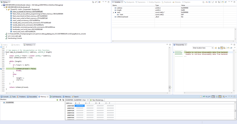

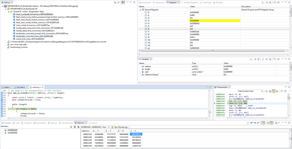

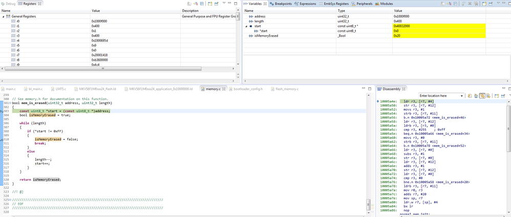

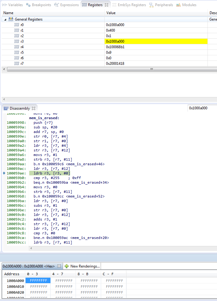

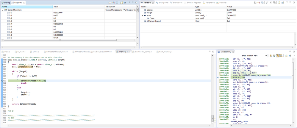

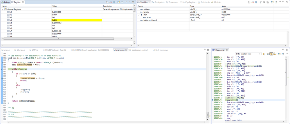

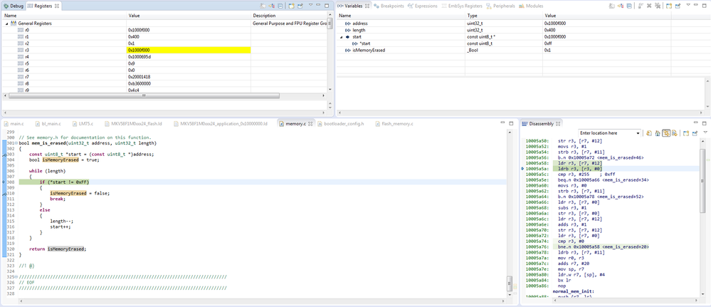

I found something really peculiar while debugging the bootloader up to the point where the "mem_is_erased"-Check fails.
In the function mem_is_erased (memory.c), the bootloader checks whether the flash from the application start address is really erased (all the bits set to 1).
Considering the General Registers, the Memory and instructionswise stepping through the code, the following occured:
in the disassembly at 100059ac, the address is loaded to the r3 register which you can see in the General Registers (lighted yellow in the picture below)
in the next step at Disassembly 100059ae the value at the address, stored in r3 should be loaded to the r3 register. This is where the problem occurs. If you take a look at address 1000A000 in the lower section of the picture, you see that the value is FFFFFFFFF... But if I take one step further:
You can see that in r3 the value 0x0 is stored. Of course this causes the condition (*start != 0xFF) to be true, ending in the isMemoryErased = false problem.
Additionally I want to mention that taking a look at the sourcecode at the same time (e.g. with the help of the Variables View), the variable content seems correct, because start = 0x1000a000 and *start = 0xff. Nevertheless the condition is said to be true... (in the below picture, the "Variables View" shows the source code variables at the debug-point in the picture above at isMemoryErased = false;)
Does this make any sense to you?

    When you debug mem_is_erased , could you check the address, and start in the function mem_is_erased, and give me the step by step, until the problem happens picture?
Kerry
10,259 Views

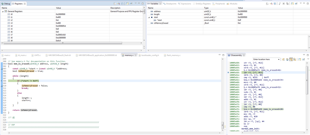

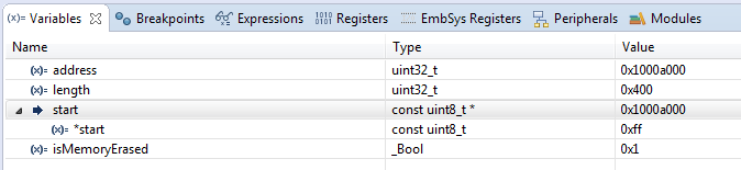

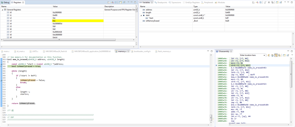

SMNJS
Hello Kerry Zhou,
these are the step by step screenshots when the error occurs:
Again I would like to mention, that this error doesn't occur after resetting the device and connect it again... Only if I update the binary, connect again to the bootloader and try to update again, the error occurs until I again restart the device.
With kind regards,
Julian Schork
10,259 Views

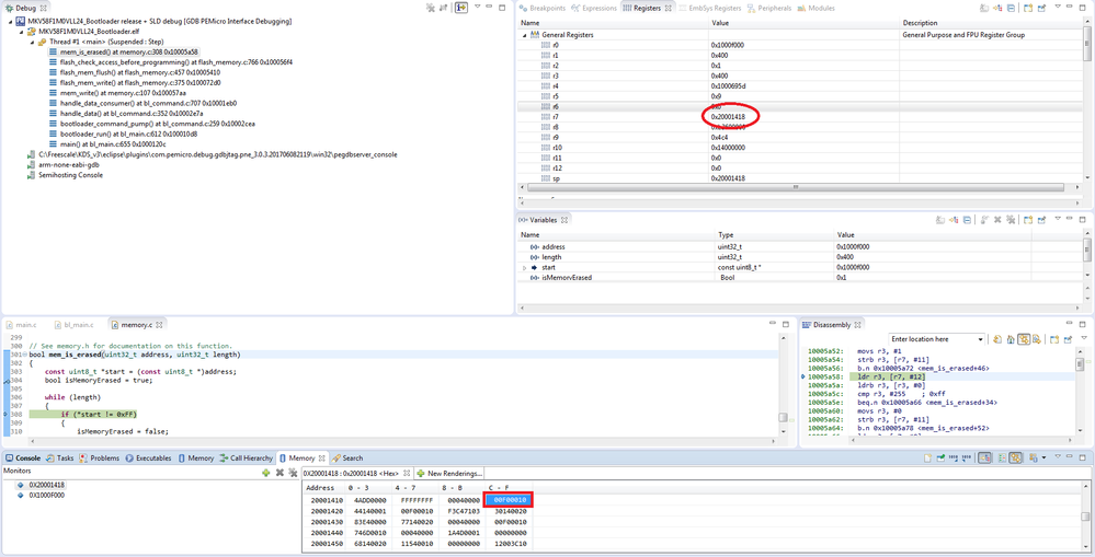

kerryzhou
picture 12 and picture 13 is really very strange.
  start address is 0x1000f000, the data is 0xff, but in the asm, it makes the data as 0.
I also need time to do the consideration.
  Could you share your modified bootloader to me?
Kerry

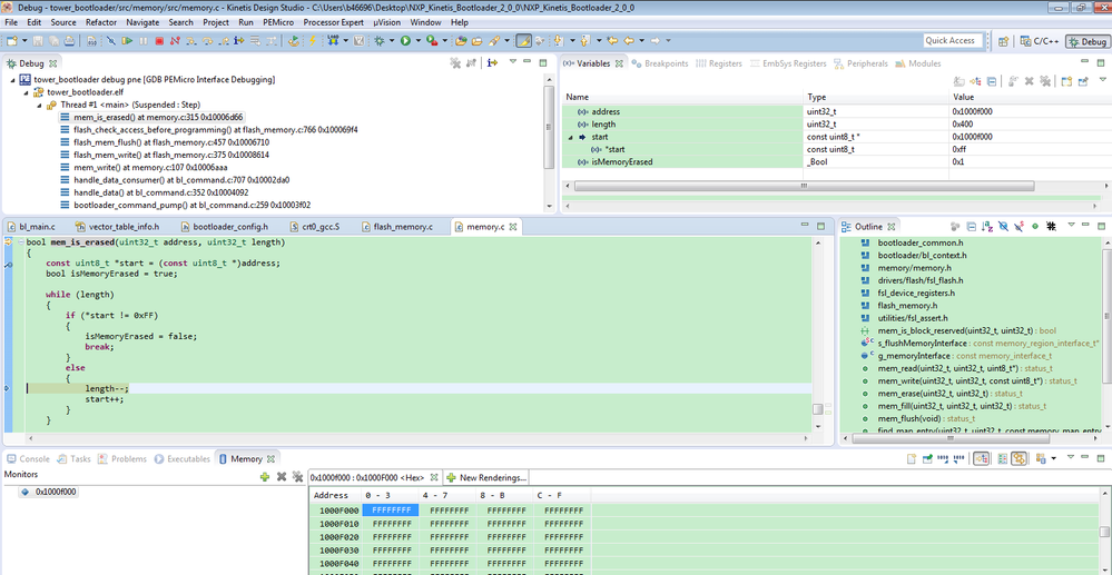

10,254 Views
kerryzhou
Hello Julian,
    This is my debug result:
Please check your problem like me, whether both memory and variable is 0xff.
Waiting for your reply!
Kerry

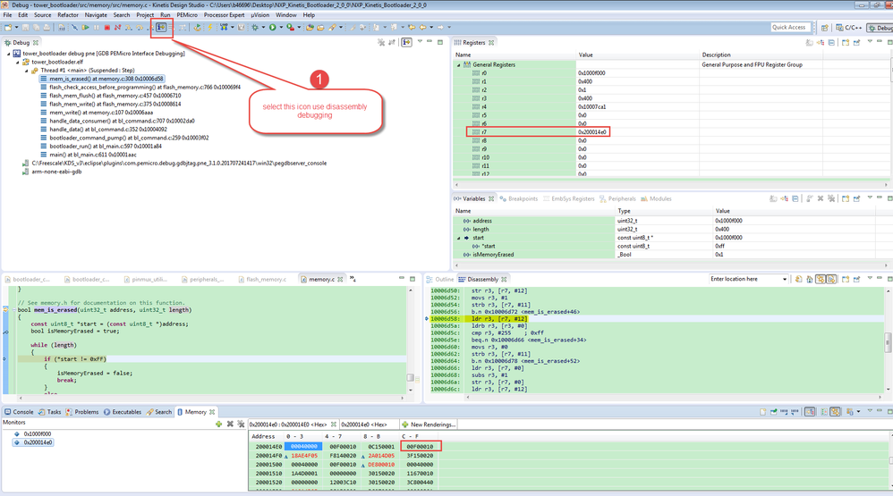

kerryzhou
Hi Julian,
    Thank you for your updated information, I think the root problem will be turn out in the near future, please follow my step, and give your problem debug picture like me:

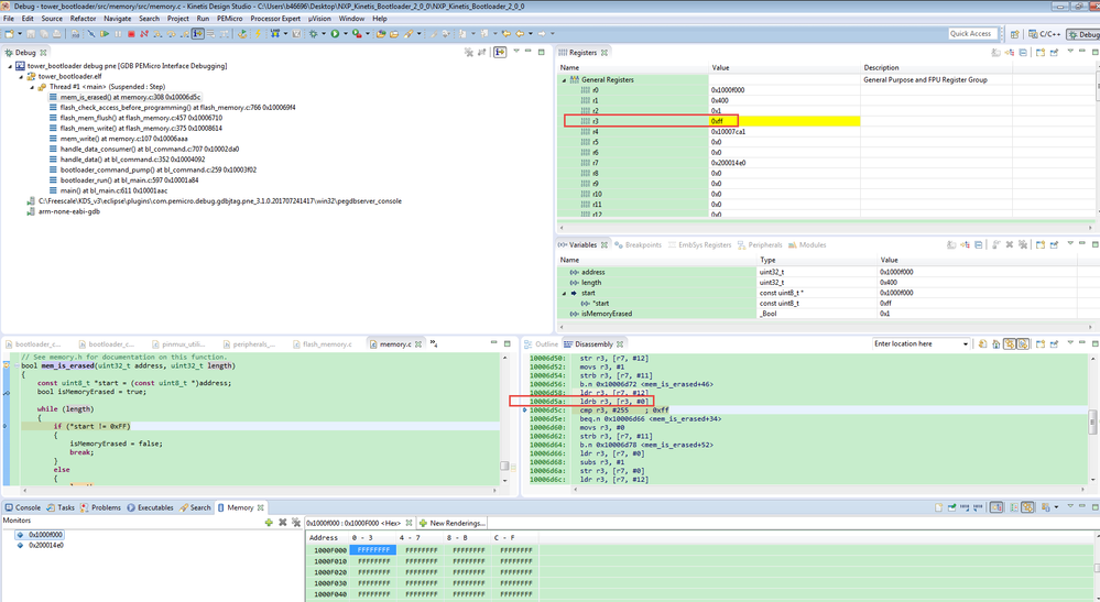

1. Use C debug enter mem_is_erased function, then choose instruction stepping mode.
I need to see the registers window, memory window and variables window, please do it like me.
Step to asm code:
 ldr r3, [r7, #12]
This code means, it will put r7+12 data to r3.
You can find in my picture r7 is 0X200014E0, 0X200014E0+12=0X200014E0+0x0c, in the memory, you can find the bytes data in 0X200014EC is: 0X1000F000, it is just the address which you want to read, the correct data is 0XFF.
Now, I need to check your RAM data which contains the flash address.
Which I am afraid is your RAM 0X200014EC already put in the wrong flash address.
2. Step into
You can find, just as we expect, the r3 is the flash address 0x1000f000 now.
3, Still step into
You can find r3 is 0XFF now.
Please do this asm debug and check the Rn register now, just like the picture on my side.
This is very important to your question.
Waiting for your debug result!
Kerry
10,246 Views

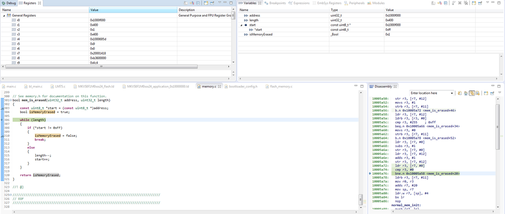

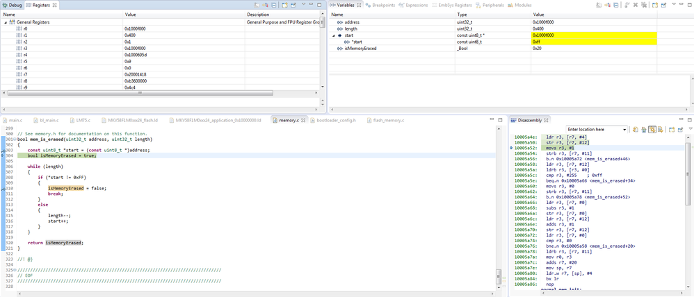

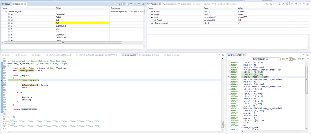

SMNJS
Hello Kerry,
sadly, this is exactly the point, where my MCU is behaving bizarre... here are the steps you need:
Step 1:
Step 2:
Step3:
I hope this helps to get any further...
With kinds regards,
Julian
10,246 Views

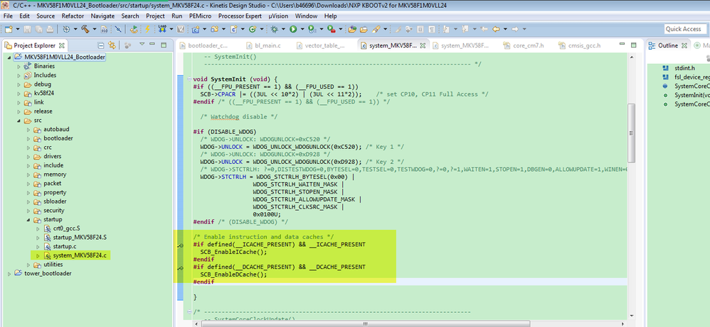

kerryzhou
Hi Julian Schork,
    Please comment SCB_EnableICache(); and SCB_EnableDCache(); in system_MKV58F24.c, then try it again, whether the problem will happen or not?

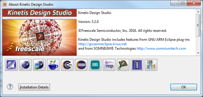

Here is my KDS version:

YES, commenting those two functions in system_MKV58F24.c fixes the issue !!
Especially not enabling the data cache, fixes the issue... the instruction cache doesn't seem to be part of the problem.
Thank you again very much for your effort!
Now I try to understand, why I have to disable the data-cache to avoid the flashing problem.
Does this issue trace back to the ARM cortex m7 core?
I wonder if there's a way to use the cache properly for my bootloader in general and my application as well...
