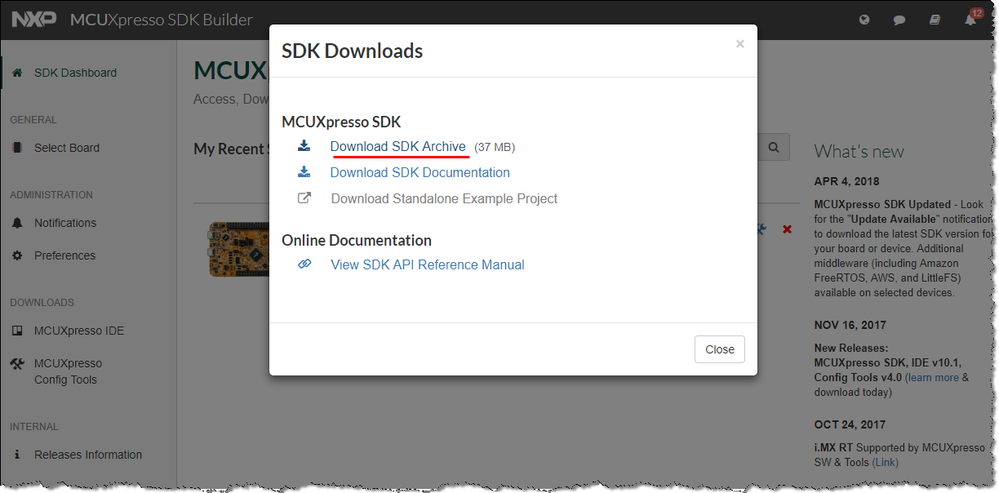

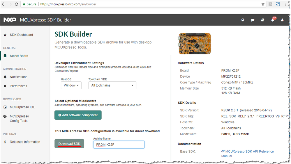

First Search MCU and Build MCUXpresso SDK.
Then Download SDK
