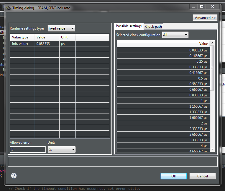

When I use the SPImaster_LDD component, I am able to send any amount of SPI data bytes without a problem. I am using interrupts. When I attempt to receive spi data, following the example found in the "help with this component", the OnBlockReceived event never occurs. When I stop execution and look at my data structure, it is always filled with n-1 of the bytes transmitted with the last byte never being populated regardless of the length of data sent.

I tie MISO and MOSI together on the FRDM board to test. I would expect the code to execute, OnBlockReceieved to be called, SPI0_DataReceivedFlag to be set to 1, and LocalTX and LocalRX to be equal.
What happens is that OnBlockReceieved is never called (breakpoint never reached), SPI0_DataReceivedFlag remains zero, and LocalRX[0] = 55, LocalRX[1] = aa, LocalRX[2] = be, LocalRX[3] = 00. I have verified with a scope that the 4 TX bytes are being transmitted correctly with  the clocks and CS. This pattern occurs for any length of data. If I set the TX and RX size to 10, 10 bytes will send successfully (verified by scope) and the LocalRX array will be filled with the first 9 and the 10th still set to zero.

Thank you for your suggestion. That doesn't appear to help.
In desperation, I was trying almost every combination of settings and found that the problem only happens for the .25 us clock period (what I happened to be using). The component functions correctly as described for any clock rate other than .25us Currently I'm running it faster at .083us period and it works fine. Same for slower rates. I made no other changes to my code. Just changed the clock config in PE.
I am still interested in understanding why this is the case if anyone has any insight.

Hi Brian,
Sorry for the late reply!
Please try to call SM2_SendBlock first then call  SM2_ReceiveBlock.
// Send the SPI data
Local_SPI0_Error = SM2_SendBlock(SPI0ptr , LocalTX, 4);
// Receive the SPI data
Local_SPI0_Error = SM2_ReceiveBlock(SPI0ptr, LocalRX, 4);
