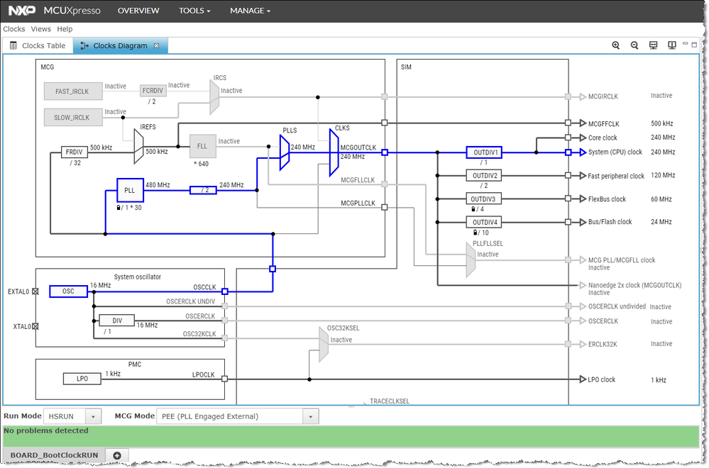

  I give up trying to use the NXP clock config tools. And I need urgently a clock_config.c and a clock_config.h files for SDK 2.0 of the MKV58F1M0VLL24.
  My board have a external 8 MHZ crystal and I want to configure the clock for the maximum CPU and peripherals clock for a 8 MHZ crystal:
CPU = 160MHZ
Fast Peripheral clock = 120MHZ
FlexBus clock = 60MHZ
Flash clock = 27.5 MHZ
Ari.
2,110 Views
Robin_Shen
Hi Ari,
According to this question, seems that you can select different frequency of crystal.(for example: 16MHz)
Here are two clocks_source which generat maximum CPU and peripherals clock for 12MHz and 16MHz crystal.
The maximum CPU and peripherals clock for 8MHz crystal can be found in 'MKV58, Need clock_config.c for a 8 MHZ external crystal'.
