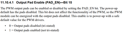

I have consulted the 56F8300 Peripheral User Manual and indeed PWM pin outputs are in tri-state if Output Pad Enable (PAD_EN) bit in PWM Output Control (PMOUT) is cleared.
So on the KV5x it is necessary to set the Fault state (PWMxFS) to either 10 or 11 to make the output tristated.
Just to clarify, tristated mode the output pin becomes high impedance when the Fault event happens, so in the case, external pull up/down resistor determines the logic of the PWM_xA, if you connect a pull-up resistor on the pin, the PWM_xA pin will be high, if you connect a pull-down resistor on the pin, the PWM_xA pin will be low.
Hope it helps you!

_Leo_
Hi Christie,
Hope it helps you!
