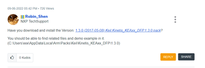

MartinFalcon95
I'm seeing the page from the link and it takes me to this:
Which of all is the version do I have to download?
6,633 Views
MartinFalcon95
Hi Robin,
Thanks your your answer. I'm seeing the post you shared me and I have a question, if I'm using Code Warrior, the package in the image, "Keil.Kinetis" will work for Code Warrior? Thanks
6,613 Views
Robin_Shen
Sorry I didn't make it clear:
I did not find example for KEAZN64, but I think you can refer to the EEPROM_demo of KE02. Download the FRDM-KEXX Driver Library Package
Then you should be able to find the example (C:\Users\nxa07315\Desktop\FRDM-KEXX-Driver-Library-Package\ke_drv_lib\build\cw\ke02\EEPROM_demo)
This project is based on CodeWarrior. You don't need to download the Keil package.
KEAZN64 is a derivative from KE02Z64, so you can use it.

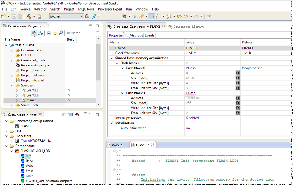

Robin_Shen
You may need to manually modify the EEPROM API in flash.c so that it does not depend on common.h and the arm_cm0.h
Sorry for the inconvenience we bring you!
These TRK-KEA64_LABTS1\2\3\4 examples contain only a few peripheral(UART\FTM\ADC\KBI) drivers.
Have you considered what to do if you need other peripheral drivers?
Maybe you should use Processor Expert to create a KE02 40MHz project, and then add the peripheral drivers you need.FLASH_LDD.pngFLASH_LDD.png

Robin_Shen
Yes. For example, if you are using KEAZN64, you can choose KE02Z64 when creating a Processor Expert project. The corresponding package needs to be configured in the project.
