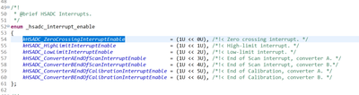

However, I don't see an option for a hardware trigger on an HSADC to pass into HSADC_EnableInterrupts()?

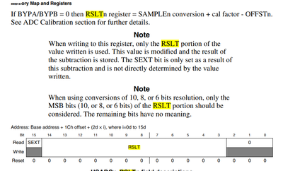

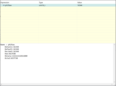

I think I figured this out - my ADC was only reading 0 to 0.38V and then rolling over. The problem was that I did not realize the format of the RESULT register:
The ADC conversion is shifted left by 3 bits. Therefore, I need to shift the value right by 3 bits to read 12 bit 0 to 4095 number.

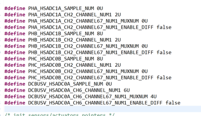

I'm having a little trouble with the HSADC. What I am trying to do is use HSADC0 and HSADC1 to get 2 simultaneous conversions on each ADC running both ADCs at the same time to get 4 simultaneous conversions.
I followed the demo twrkv58f220m_hsadc_dual_parallel_conversion. The only difference I made was that I am using both HSADCs and also I don't want differential conversions so I have enableDifferentialPair false on each channel.
This is my setup:

hsadcSampleConfigStruct.channelNumber = DCBUSV_HSADC0A_CH6_CHANNEL_NUM1;
hsadcSampleConfigStruct.channel67MuxNumber = DCBUSV_HSADC0A_CH6_CHANNEL67_NUM1_MUXNUM;
hsadcSampleConfigStruct.enableDifferentialPair = DCBUSV_HSADC0A_CH6_CHANNEL67_NUM1_ENABLE_DIFF;
HSADC_SetSampleConfig(HSADC0_BASEADDR, DCBUSV_HSADC0A_SAMPLE_NUM, &hsadcSampleConfigStruct);
/* For converter HSADC0 Conv B. */
/* For converter B.
* In HSADC_SetSampleConfig(), the channel number 0~7 represents input 0~7 of converter A and channel number 8~15
* represents input 0~7 of converter B.
hsadcSampleConfigStruct.channelNumber = (PHC_HSADC0B_CH2_CHANNEL_NUM1 + 8U);
hsadcSampleConfigStruct.channel67MuxNumber = PHC_HSADC0B_CH2_CHANNEL67_NUM1_MUXNUM;
hsadcSampleConfigStruct.enableDifferentialPair = PHC_HSADC0B_CH2_CHANNEL67_NUM1_ENABLE_DIFF;
HSADC_SetSampleConfig(HSADC0_BASEADDR, PHC_HSADC0B_SAMPLE_NUM, &hsadcSampleConfigStruct);
/* For converter HSADC1 Conv A. */
hsadcSampleConfigStruct.channelNumber = PHA_HSADC1A_CH2_CHANNEL_NUM1;
hsadcSampleConfigStruct.channel67MuxNumber = PHA_HSADC1A_CH2_CHANNEL67_NUM1_MUXNUM;
hsadcSampleConfigStruct.enableDifferentialPair = PHA_HSADC1A_CH2_CHANNEL67_NUM1_ENABLE_DIFF;
HSADC_SetSampleConfig(HSADC1_BASEADDR, PHA_HSADC1A_SAMPLE_NUM, &hsadcSampleConfigStruct);
/* For converter HSADC1 Conv B. */
/* For converter B.
hsadcSampleConfigStruct.channelNumber = (PHB_HSADC1B_CH2_CHANNEL_NUM1 + 8U);
hsadcSampleConfigStruct.channel67MuxNumber = PHB_HSADC1B_CH2_CHANNEL67_NUM1_MUXNUM;
hsadcSampleConfigStruct.enableDifferentialPair = PHB_HSADC1B_CH2_CHANNEL67_NUM1_ENABLE_DIFF;
HSADC_SetSampleConfig(HSADC1_BASEADDR, PHB_HSADC1B_SAMPLE_NUM, &hsadcSampleConfigStruct);
/* Enable the sample slot. */
uint16_t sampleMask = HSADC_SAMPLE_MASK(0U) /* For converter A. */
| HSADC_SAMPLE_MASK(8U); /* For converter B. */
HSADC_EnableSample(HSADC0_BASEADDR, sampleMask, true);
HSADC_EnableSample(HSADC0_BASEADDR, (uint16_t)(~sampleMask), false); /* Disable other sample slots. */
HSADC_EnableSample(HSADC1_BASEADDR, sampleMask, true);
HSADC_EnableSample(HSADC1_BASEADDR, (uint16_t)(~sampleMask), false); /* Disable other sample slots. */

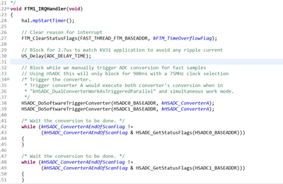

I have a FTM keeping a 250us interrupt for me and am kicking off the ADC conversion there:

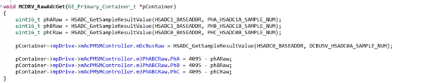

Then to read ADCs I am doing this:
Do you see anything wrong I did in the setup? What is strange is that these are 12 bit ADCs and I seem to be getting a 16 bit number returned from the function:
4,264 Views
derekcook
Senior Contributor I

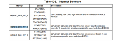

derekcook

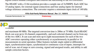

I don't even see mention of a hardware interrupt option.
Worst case I can use PDB to trigger an interrupt on ADC0 and then in the ADC0_IRQHandler I can manually do my HSADC conversions I need. If the sample time is 200ns with 75MHz input clock this is not a big deal. I really don't even need the PDB at this point - I could use an FTM to trigger a 250us interrupt
