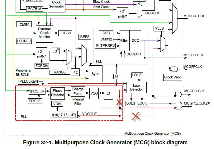

The datasheet for the MKV5X has the following values in Table 17 for the PLL:
Reference Frequency Range: 8 to 16 MHz
Ipll @ 176 MHz: 2.8 mA (Note says fpll_ref = 8 MHz, VDIV = 22, 8 * 22 = 176 MHz)
Ipll @ 360 MHz: 4.7 mA (Note says fpll_ref = 8 MHz, VDIV = 45, 8 * 45 = 360 MHz)
This seems to indicate that the feedback for the PLL comes directly from the VCO output.
However, this contradicts Figure 32-1 in the reference manual.  This figure shows the feedback being derived from the fixed divide-by-2 MCGPLLCLK output.  I confirmed using the FlexBus clock output pin and the PIT that the PLL N-divider appears to actually be connected to MCGPLLCLK2X.  Can you please confirm if the following markup is correct?

Hi, Shawn,
If above figure is correct, the VCO output frqeuency(MCGPLLCLK2X) is 8MHz*VDIV*2, MCGPLLCLK is 8MHz*VDIV.
I will test it tomorrow, can you post the PLL setting code here?
Xiangjun Rong

Xiangjun,
Yes, I believe that's correct.  In my application I have a 10 MHz PLL reference frequency and would like MCGPLLCLK/MCGOUTCLK to operate at 160 MHz.  In the original Figure 32-1, it led me to believe VDIV should be set to 16.  I actually have to set it to 32, meaning the VDIV input must actually be connected directly to the VCO output (MCGPLLCLK2X).  Code is below:

Hi, Shawn,
Okay, i see, the /2 divider is not in the feedback loop as the figure.
