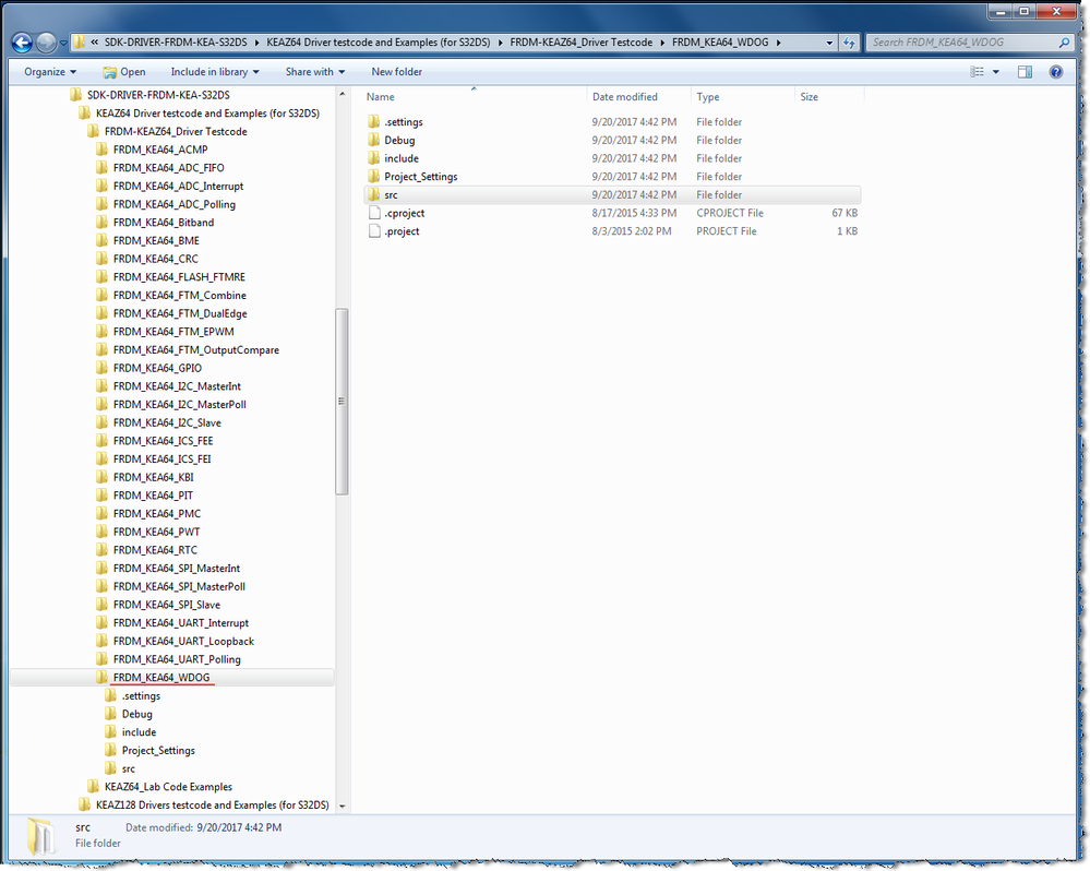

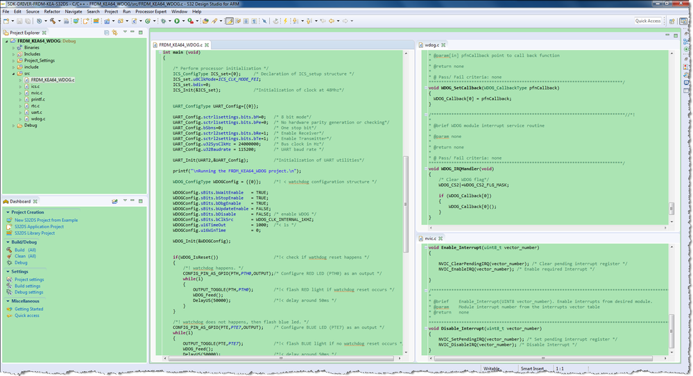

Please download the 'SDK Software Drivers for KEAZ128_KEAZ64 using S32DS' and refer the FRDM_KEA64_WDOG example. You can open this example by using S32DS: S32 Design Studio IDE.
