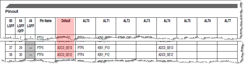

I am using KE06 LQPF package, and configuring pin29/PTF5 to 0/low as initial value.
It seems pin29/PTF5 still keeps at 1/high when power up, and goes to 0/low after about 500ms.
How to configure/set the initial value of pin29/PTF5 to make sure it is 0/low when power up.
1,144 Views
Robin_Shen
Hi cl chen,
This pin is default as analog function.
If you want to make sure it is 0/low when power up, you may need to add external pull-down resistor on this GPIO.
