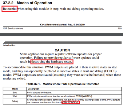

I am having an issue with the KV46F256 microcontroller when connecting to it via FreeMASTER using BDM communication plugin OR also when just setting a break-point at a part of the code that is not being executed while the code is running.
I noticed that my motor was doing a noise every time I set a break-point or any time I try to connect via FreeMaster. Looking the PWM signals for my phase U upper switch I found the following:
There is an interruption of the PWM signals for about 8.8 milliseconds then it resumes to normal operation. I really believe this should NOT be happening specially when connecting with FreeMaster as this can cause damage to bigger motors.
Is there a way to stop this interruption of the PWMs when connecting to the micro via FreeMaster and/or setting a break-point?
I am using the latest version of SDK for the KV46F256 micro, I am using the MCUXpresso IDE v11.2.0 [Build 4120] [2020-07-09] and my debug probe is the Multilink Universal FX.

FelipeGarcia
I've received feedback from Freemaster team.
Just to confirm - I hope the glitch on PWM signal is only observed when FreeMASTER is just establishing connection...? It should NOT be observed during normal communication - that would be really bad.
When FreeMASTER is connecting (and also when a debugger communicates with target while setting a breakpoint etc), the JTAG temporarily forces the CPU to a background/suspended mode to analyze the connection. I think it is normal/default behavior that the peripheral clocks are suspended during this period - causing the PWM glitch. The KV4x reference manual writes about it in section 37.2.2. It may indeed be dangerous to the motor hardware.
The customer should consider setting the CTRL2[DBGEN] bit in PWM configuration.
Hope it helps!
Felipe

plinioandrade
Felipe,
The problem with that approach is:
My PWM will not stop anymore but the duty cycle will be kept constant (because CPU isn't running to recalculate the new PWMs) for the same amount of time which translate to applying DC voltage to the motor (high currents are produced).
So, it seems like this is a glitch that can cause issues no matter what.
Do you know if this is something that NXP/ARM is planning to fix in a soon-to-come future?
