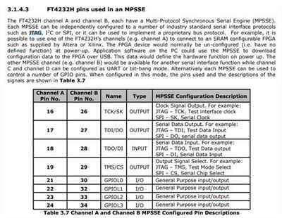

Hello Team,
Could you please advise if it possible to use the FTDI chip for programming the KV31 MCU family using the JTAG interface over MPSSE?
The FTDI contains four channels and one of the interfaces is MPSSE which supports JTAG which It will be great if we can program the device via the FTDI.
Please refer to the FTDI datasheet: https://www.ftdichip.com/Support/Documents/DataSheets/ICs/DS_FT4232H.pdf
Waiting for your kind response, Thanks in advance.
Shai

Hi Shai,
We have no experience on this chip. You'd better consult to Future. I guess it is possible. KV31 JTAG port is a standard port.
Jing
