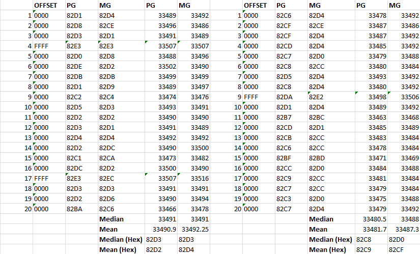

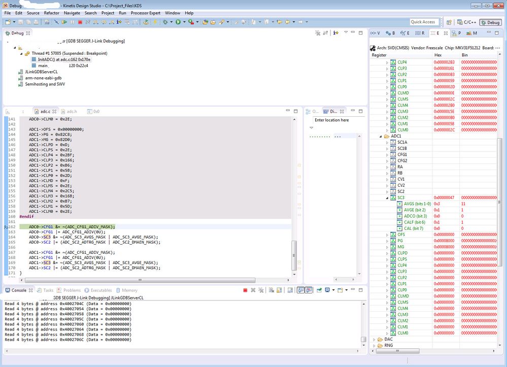

We've run into a performance limit on our application when using an uncalibrated ADC.  However, we've seen issues when attempting to perform the internal Kinetis calibration.  Device is a MKV31F512.
1)  The major problem is that when running the initialization code below for both ADC0 and ADC1, the ADC1 calibration always returns with 0 values.  I've tried different combinations of COCO and CAL flags but the results are always the same.  The only way I can get a result appear is to breakpoint on the line "tmp32 = ADC1->CLP0 + ADC1->CLP1 + ADC1->CLP2 + ADC1->CLP3 + ADC1->CLP4 + ADC1->CLPS;".  The input bus clock to the ADC modules is 24 MHz.
2)  Minor issue is that occasionally the calibration occasionally gives outlier results.  The offset goes to -1 in these cases.  I've used the breakpoint method above to gather ADC1 data.  I've read you need to run the calibration 20 times and apply a median filter but it appears some thing isn't correct in the hardware.
Any ideas on how to properly poll the calibration status and ensure the ADC1 calibration completes correctly?
Shawn

Thanks for the response.  I believe I am running the ADC < 4 MHz as suggested.  I set the input clock divider to 8 in the following line:
ADC0->CFG1 |= (ADC_CFG1_ADIV(3U) | ADC_CFG1_MODE(1U));
I used the code from the latest SDK to create my function.  I've copied it below.  I don't see any major differences.  I'm using COCO as the condition flag for determining if the calibration completed.  This seems to be in line with the documentation you suggested.  I'll keep digging to see if I can find the exact timing issue.  If I breakpoint at "tmp = ADC1->R[0]", the CALF flag is 0 and the calibration values look good.  If I allow the function to run to the end the CALF flag is set.  I'm speculating that for some reason the code thinks the calibration is complete and attempts to write the ADC1->PG register.  The would induce a calibration failure per the reference manual.
Shawn
